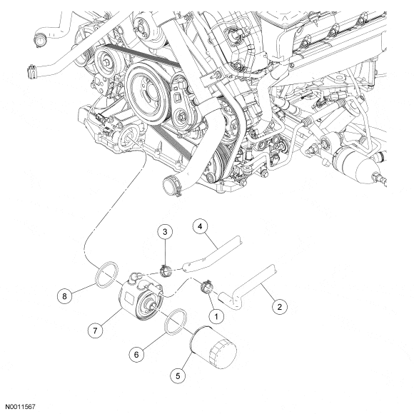

If yours is a sport, then there will be an oil-to-water oil cooler between the oil filter and the oil filter adapter. Is it leaking between the cooler and the adapter? If so, that's just a gasket. If it's leaking between the adapter and the engine block, it could be the gasket there, or it could be the adapter itself.

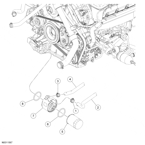

Here's a drawing of the oil cooler (item 7).

old thread bump, but does anyone have a part number for the oil cooler o ring gasket? #8 in the diagram.
Sorry, no, but if you take that picture to your local Jaguar dealer they might either have it in stock or be able to get it quickly. When I did my cooling system I didn't order enough of the rubber seals. The local Lincoln dealer parts guy looked at me with a vacant look before saying they couldn't get it. Told the Jag dealer that I needed the cooling seals on top of the engine, and he knew exactly what I was talking about and had me the seals I needed the next day.

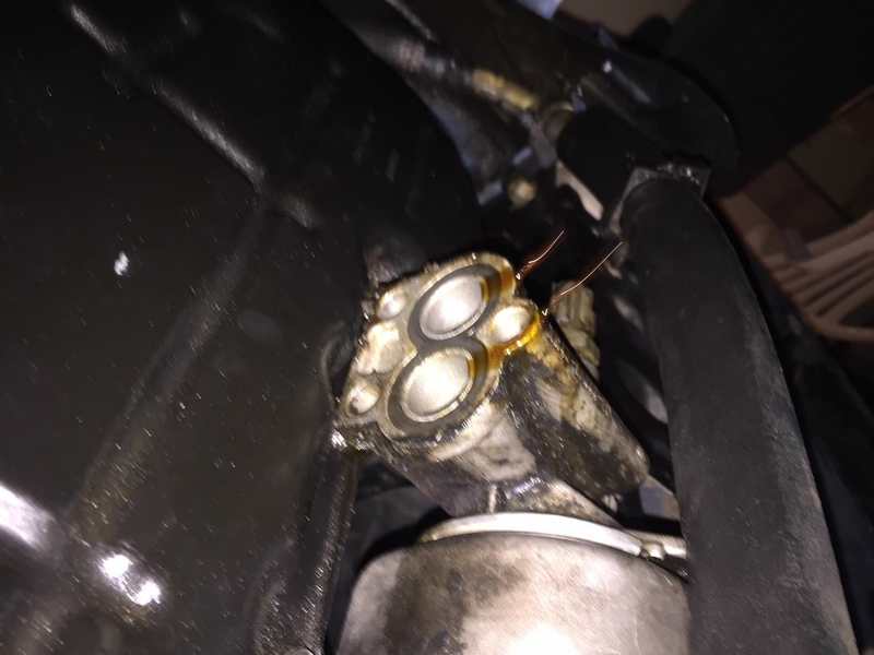

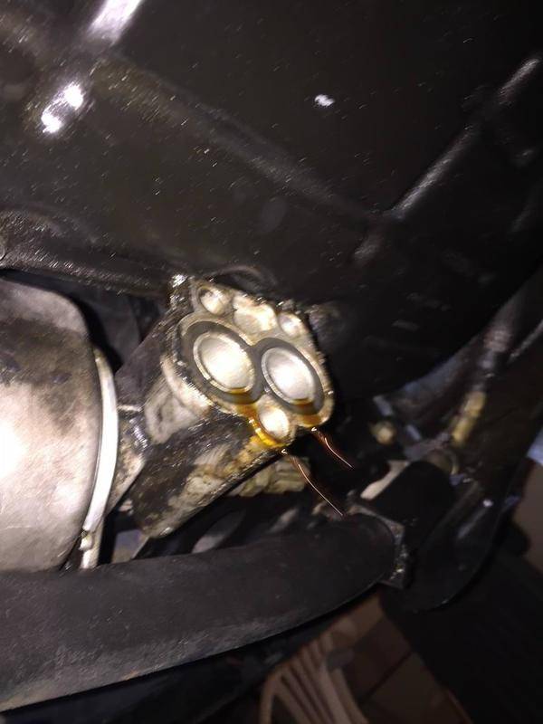

But I am doing the oil filter adapter gasket here in a few weeks to hopefully solve a bad oil drip. This is the only place I can figure out it would be coming from. The repair manual says to remove the oil cooler. However, it seems possible I can just remove the adapter (with cooler still attached) and place in a new gasket...

I would remove the filter to get that oil out and get a bit more room. Then just unbolt the adapter with the cooler still on it. Clean, new gasket, reinstall. Very quick job assuming the bolts aren't frozen.

I had time over the weekend to tackle the adapter gasket. What a total PITA to work in, at least without a lift it sucks trying to maneuver various extensions and such to reach 3 bolts that were extremely snug.
Unfortunately it appears this did not solve the leak, and I could not figure out where it was coming from. Perhaps somewhere above the adapter, because the entire thing had oil and such all over it. (Perhaps this is the same issue on Joe's 2004). I just looked @ the task of replacing the front engine cover gasket.. and haha yea right!
