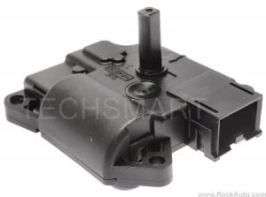

this is what they are calling im guessing the temp blend door. when i tore apart my dash i seen an exact part just like this one located on the drivers side. it was right next to the same location of the heater core but of course outside. getimage.jpg
this is what they are calling im guessing the temp blend door. when i tore apart my dash i seen an exact part just like this one located on the drivers side. it was right next to the same location of the heater core but of course outside.View attachment 828460814
Controls where the air flows, not the air temperature.
The DCCV controls temperature.
You have no control of temperature and you have codes for a circuit fault with the DCCV. Why not accept that this is the area of your problem? If any of the wires going to the DCCV are broken, you will get full heat. If the DCCV itself is bad, you'll usually get full heat. If the connector at the DCCV is not fully seated, you'll get full heat. It's also possible there is a fault with the DATC. I linked the troubleshooting steps that allow you to determine exactly where the fault is (the DCCV itself, the wiring, or the DATC). Why not check it?
