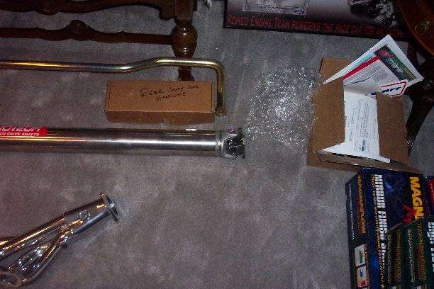

Here are pics of above to go into one of mine
:L
Drive Shaft
