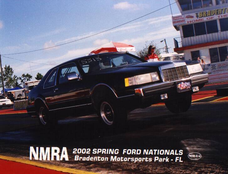

Nah, not really. Don't know the first thing about nitrous, although my bud Nick wants me to get it to see if I can beat his 11.95 @ 113
His car, back in the day on the juice:
''Nitrous is like a chick with an STD. You want to hit it, but your afraid of the consequenses!!'' that was by far the funniest thing i've heard in a while hahahha.
DAMN!!! That's a hell of a launch, what did he have for mods?
Heads, exhaust, 4.10, Tremec TKO, nitrous from what I can remember. We're chillin' tomorrow so I'll ask him again lol
Sticky tires and a 6000rpm launch help though ;)
