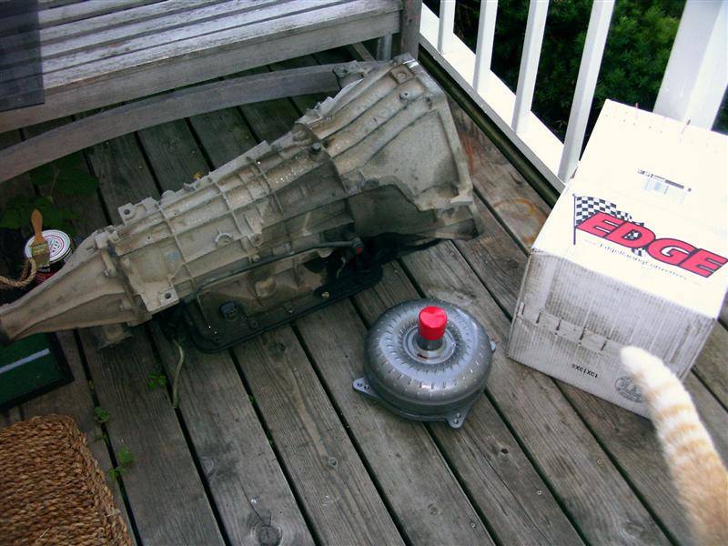

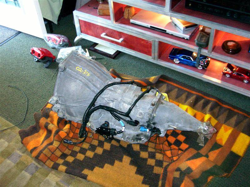

Moes8,
Here are the two tranny's. The one with the ribs on it is supposed to be a 97 out of a Mark. I just thought its odd that they look so different.
Greg
ok,i see what you are talking about,anyway
line them up and make sure the bolt up areas are the same,i am sure they casted them differnet over the years,
the one you said is 99 is definately 99-00 based on the tag id
its a great one to install.has mechanical diode clutch and updated valve body,
nice edge tc,wish i had the $ when i did my trans swap for a tc.

Sorry, I didn't mean sizes. I meant to say cases. They look totally different and I was just wondering why they would change the case on them. I'm guessing my 96 will have a case like the 97? I guess I will find out this weekend.
