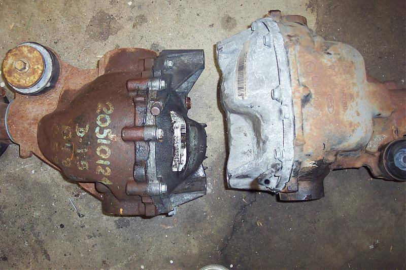

Bought a 2003 diff w/ 3.58 to swap in my 01, has anyone done this before?
Just pulled the 01 diff out...
When comparing the 03 diff to the 01 the cases are different. THe 01 is wider (from axle inlet to axle inlet) than the 03. By about an .5-1 inch. SO i am a little worried. All of the mounting points are exactly the same, so mouting it will not be a problem, but im worried about the axle shafts being in the right place and sealing. Any thoughts???
I know that an 04 Thunderbird diff will work on an LS (a member has done it) but i thought there was no difference from teh LS to the thunderbirds...

Jason,
The 2003 Diff will not work in our cars. 02V8Sport accidently told me an 04 went into his car when it was actually an 02 Diff from a t-bird(that had the 3.58) So, tomorrow im going back to Waukesha to return the 03 diff, then possibly going to elgin to pick up a 99 LS diff, or 02 t-bird diff. Which then should fit.
I have the car at a friends right now, driveashaft zip-tied up and axles sitting, waiting.
So, 03-06 difs will not fit 1st gen LS's, end of story. Axles are beefier on the 2nd gen models. However, the gears can be swapped from any year, for they are all 8" ring and pinions.

I made a mistake when telling Devilsh my diff in my old 02 LS was out of an 04 T-bird, since that is what they yard told me it was out of when I bought it from them. It was actually out of a 02 T-bird.
For the 00-02 LS you can use the late 99/early 00 diffs which have the 3.58 or the 2002 T-Birds only.
The 03+ Tbird and 03+ LS's have a different carrier. and only interchange between the 03+ years.

I went to Southbend IN(3 hour drive each way) and picked up a 2000 LS 3.58 diff yesterday for 200$. We got it in last night at around midnight and After getting some gas went to test it out.
All I can say is this is probably the best 200 dollars i've ever spent! 1st and 2nd dont show much of a durastic change, but third is very strong. VERY STRONG. 1st and 2nd are also a little shorter and 3rd comes in around 50 instead of right by sixty. (in D5mode) But third is the moeny gear. From about 60-95(right before 4th) this car MOVES OUT! very strong acceleration.
The diff went in pretty easy it took us about 4hours to get the old one out but only about 45 min to ge thtis one in. I had to remove my exahust, unbolt the middle driveshaft bracket, and loosen the suspension a lil to ease the install, but evreything works, and man does it wokr nice.

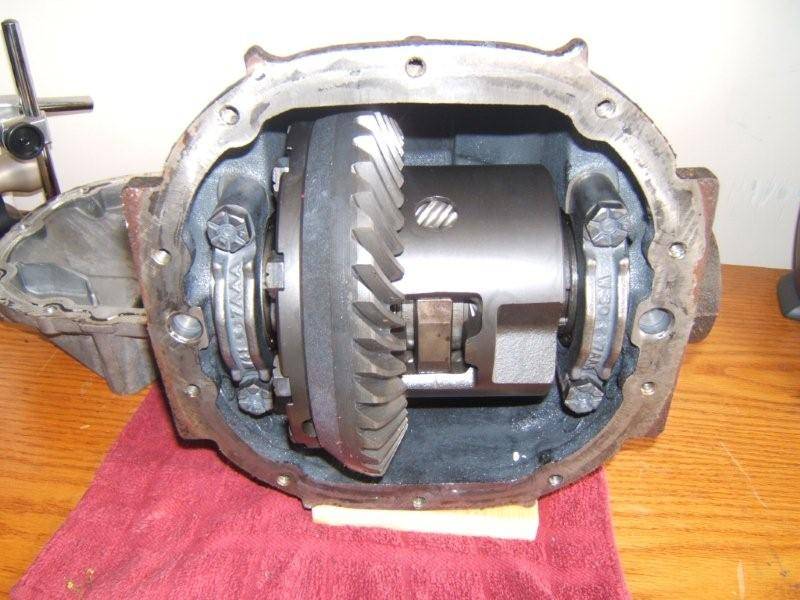

Actually I think you guys mean Traction Loc as Ford calls it. GM uses the Posi-Traction name. Powers both wheels when loaded. Limited slips don't.
No aftermarket made that anyone has discovered. The ring and pinion arrangement of the old 8" Ford is likely different by design...would a aftermarket Traction-Loc for that work??? Doubt it.
If you gonna go aftermarket, I don't think anyone makes a differential for LS that could be swapped.
I think if you wanna put it apart and change the gears that would not be a problem to do.
I remember someone in LLSOC getting TORSEN gears to put into LS differential but I didn't stick around long enough to see results, if any (not that is impossible, but just not done).

BTW, the LLSOC Torsen project is under way, but it's sitting in the project queue of the guy who has it now.
Yeah I belive Lous has the Torsen diff sitting in an LS case, they just need ot finalize it... Hmm may be an idea for my old diff sitting around.
Any idea of a part number or something of the TORSEN gears?
What do I need know about differential in LS to replace the gears with at least LSD type gears?
$400-500 for these diffs is just nuts!! Ive seen them a low as $100 in various parts of the country. Im glad you found one for a good price.
