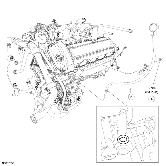

just replaced my VGC's , had to remove dipstick tube and cant find the little hole it seats into . where the hell does it go? I been over and under the car trying to see where the hell it goes in and no luck.......
does this help?
i dunno if it's in the same place for first gen :shifty:
Been there, when I did mine, it probably took me about 1/2 hour to find it. There is a hole for it, it is on a flat horizontal surface. You can just about see it, but not really, I believe I set the dipstick in as close as I could guess, and got under the car and felt around and found it from there.
Thank you guys......I really apprecite the help!! couldnt have done it without ya.....who would have thought that was the hardest part of the whole job!!
