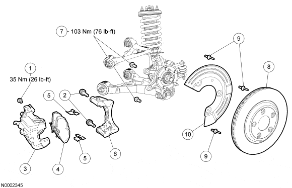

Are you saying that item 5 below is missing?
Yup - no squealers on this set up - last person must have removed them. I'll just have to keep an eye on the pads. So what's odd - is the back right break has 85% life, no tabs, and is squealing 7 out of 10 times i push the brake down , loudly. stranger yet that it doesn't do it every time... right now everything is back on, just cleaned and oiled better - we'll see if that makes any difference at all...
