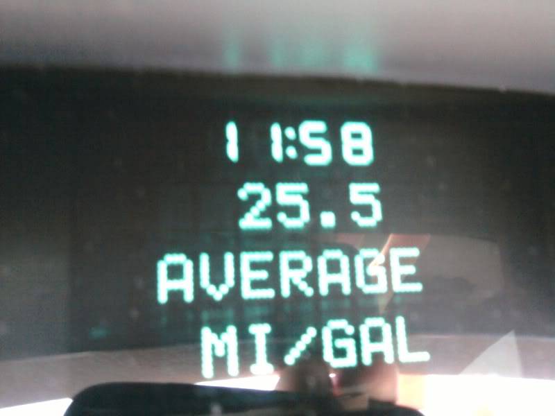

This is what mine shows on flat hwy. Some get better than this, like 27, 28
ed you have something real wrong because i can get 24 mpg at 75 with 4:30 gears in my 97 lsc. and for my gears thats some good gas mileage. even around town i average 14.8
yeah. its gotta be major. i've seen 26 on an open highway with 4.10s and still do 16 ish in town. i can drop into the teens on a hilly road (like to school and back) and driving hard but 19 highway is nuts.
