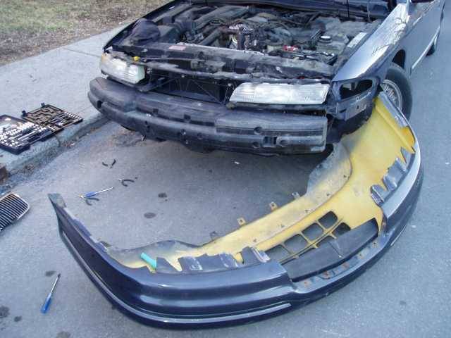

i just removed it, installed the grille, and put it back, took me about 2.5 hours.

well, it wasn't a pleasant task - a lot of the bolts were very rusty and some broke.

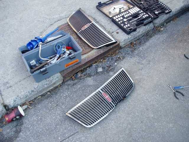

i have DURING pics:

I used 3 of these cuz I already put my bumper cover back on .
I cut the round head in half to get them to fit in the grill . The grill is mounted good this way,
