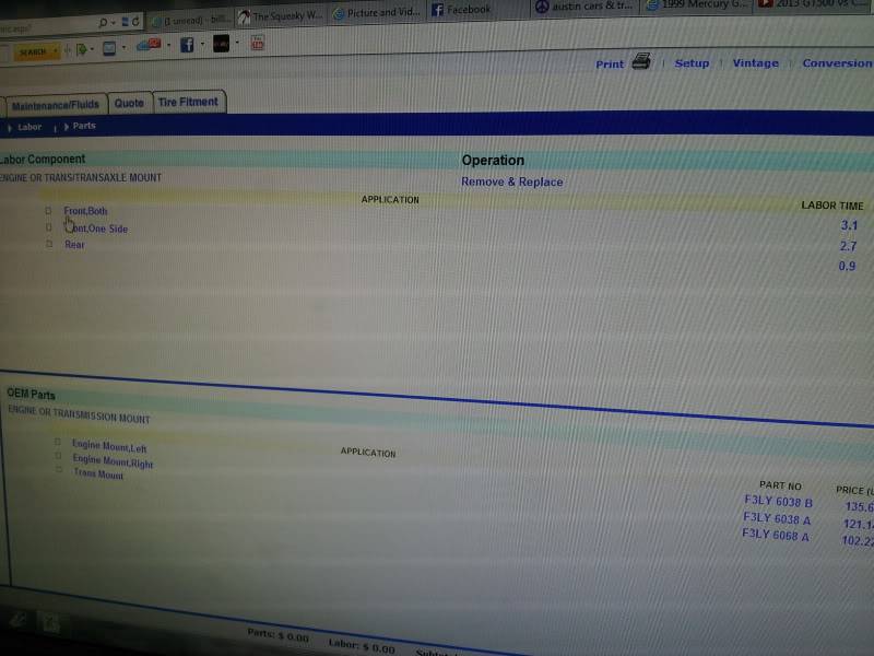

Gawd I wish I had not read this ...now I will have to check mine! So does anyone who reads these threads know if the passenger side motor mount can only be replaced by dropping the subframe. I took my 8 to a local shop and he quoted me a worst case scenario of 600 for replacing the mount, repair the broken stud that holds the air manifold to the throttle body, replace the steering wheel with a "new" one. It sounds like a reasonable quote so I gave him the go ahead. I had to bite my lip howver when he said he thinks I made a mistake not doing a coli conversion. I was hoping to find a procedure on this forum or evidence that one could replace the p-side motor mount without dropping the subframe...but just to really try to educate him with the details of this car...that could backfire (pun inteneded)! Blah Blah...thanks. I have been focused on my 91 Bimmer so my restoration progess is slow but a sure thing!
$600? Parts included?
Easy way is to disco battery, drop exhaust pipes (cats back) , drop starter, remover lower bolt thru sub-frame, slightly lift engine with trans jack, remove mount bolts from block, install new mount. Reverse
A good tech could have this done and back on the ground in less than an hour and a half
