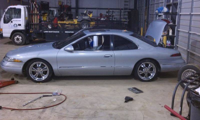

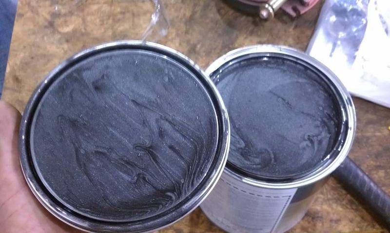

decided not to go satin. probably going to sell this one when finished
its not bad really.
we are talking wheels right?
also, you have a blown strut rod bushing or bad alignment. your front wheel sits too far back in the wheel well.
its not bad really.
yes wheels
srb, replacing after the lsu al game. 3rd set in 6 mo.

if you keep wrecking srb's its because someone doesnt know how to allign the car. your front end is way off, even if the bushing was bad that strut rod shouldnt allow the spindle to sit that far back. i went through this two times in a row through this with tire kindom, they alligned my car after i rebuilt the front end, and when i went to get it, thats how the left front tire sat, i said i am not taking the car like that, bring it in and fix it right, so they call me 2 hours later and say its all set, i go back, and the tire was still slammed in the back of the wheel well, i said you have got to be kidding me, i said give me my money back and i will go somewhere that knows what they are doing. so i took it to ford and an hour later it was mint, ford said someone had the front sr nut backed too far off so it shoved the spindle backwards. get the car alligned at the dealer, i never take my vehicles to these discount imbred employed places anymore for allignments, only the dealer.
no. the blue moog SRBs are crap. i put a set on on my car, stomped on the brakes and crushed them.
swapped to oem and they are fine.
the moog bushings are thermoplastic. the material is very stiff. it has little give and instead of squishing, it will crack and split. bad material for SRBs.
