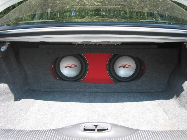

Definitely take the time to rewire. It's worth the effort. Before I decided to rewire everything, I was having a problem with noise coming through the speakers. I just ended up replacing everything. Kenwood head unit, Alpine compnents in the front (with tweeters in original tweeter location), Alpine 2-ways in rear and Type-R 10"s in a custom box in the trunk. The amps I put in the existing amp rack after cutting all the tabs off.

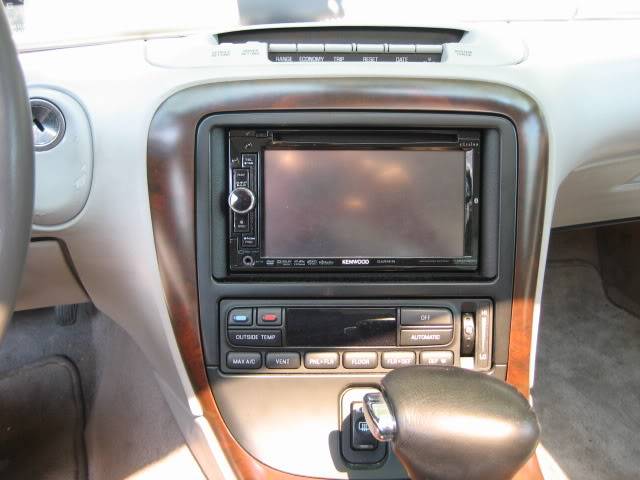

its a CDA 9884.
runs a 4 channel Alpine amp that i like in my trunk, and a 1 channel no-name sub amp that i don't really like.
i want to replace my sub amp with an older rockford fosgate like i used to have, and upgrade to component speakers up front using the stock tweeter location. i have no name 3 ways right now.
its loud and musical, and right now that's getting the job done.

I checked out all the Pioneer stuff and IMO the Kenwood eXcelon series has better options and a more user friendly interface. And here are a couple pics.
its a CDA 9884.
