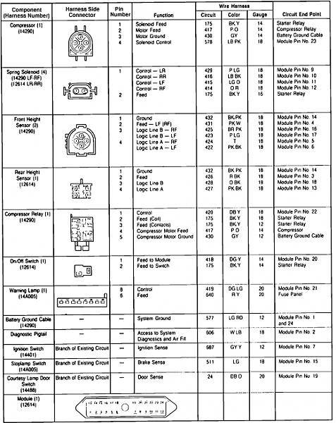

Does anyone have a pinout for the air suspension on the Mark VII?
96hotrodlincoln
Jan 10, 2006
1,378
St. Louis Area
So I got a question about a Ray Switch on a Mark VII and I'm going to need the pinout to know which wires are which. Does anyone have this?????
I got a question from a user if I could make the "Ray Switch" work on his 90 Mark VII. I just need a pinout of the Suspension module, so I can figure out what wires need to go where.
I can't help tonight. I will upload the schematic when I get to work at 7 am.
Hope this helps.
