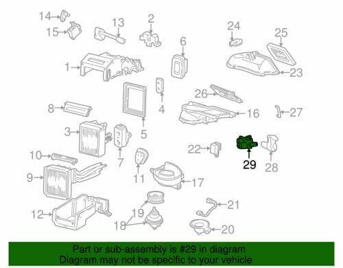

Not much to that one.
Mode Door Actuator — Air Inlet Door
Printable View (39 KB)
Item Part Number Description
1 19D887 Air inlet mode door actuator electrical connector
2 18A481 Air inlet mode door actuator linkage retaining clip
3 W701696-S Air inlet mode door actuator screw (2 required)
4 19E616 Air inlet mode door actuator
Removal and Installation
  1. Remove the RH floor duct.
  1. Disconnect the air inlet mode door actuator electrical connector.
  1. Remove the air inlet mode door actuator linkage retaining clip.
  1. Remove the 2 air inlet mode door actuator screws.
  1. Remove the air inlet mode door actuator.
  1. To install, reverse the removal procedure.

Ok, Thanks @joegr My one main mechanic said it wouldn't be a problem for him. He said he has done a bunch of them in his time and said they should be fairly straight forward to change. I will pass that part of the workshop manual onto him thanks.
