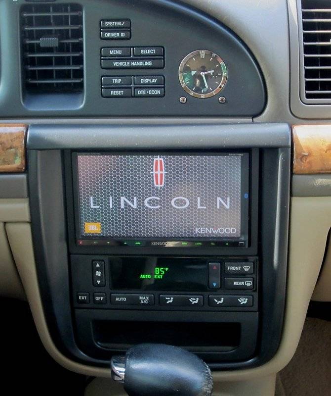

Technically, no. Realistically, yes.
The opening is about 1/8th inch too short for true 2 DIN. You have to cut away the trim across the top of the front trim piece. The location of this cut means you'd have to be on the floor to see where you cut so it's easy to do with a Dremel and still look OEM.
There is nothing to trim on the sides or the bottom. If you pull the radio and insert the new 2DIN cage, you'll see exactly where you have to cut to make things fit. You'll notice there's a larger gap on the passenger side and that's on purpose; the electronics are slightly angled toward the driver's side.

You'd have to work hard to see the cut even if you put the stock radio back in place. That trim piece sells on ebay for around $40 so you're not hacking up an expensive part anyway.
