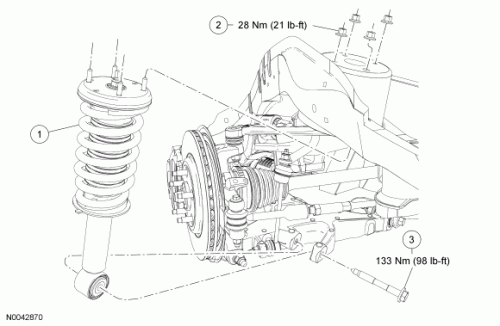

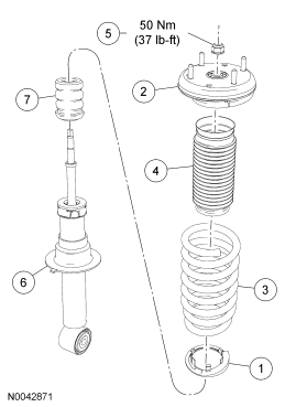

I have the front done.  I rented a good spring compressor from Autozone.  I have a Rigid impact gun 450 ft/lb so no problems there.  Is there anything I should know about doing the rear.  My understanding is I jack up the car.  Remove 4 nuts on top, then remove the large bolt on the bottom.  Then remove the shock assembly.  Thanks
