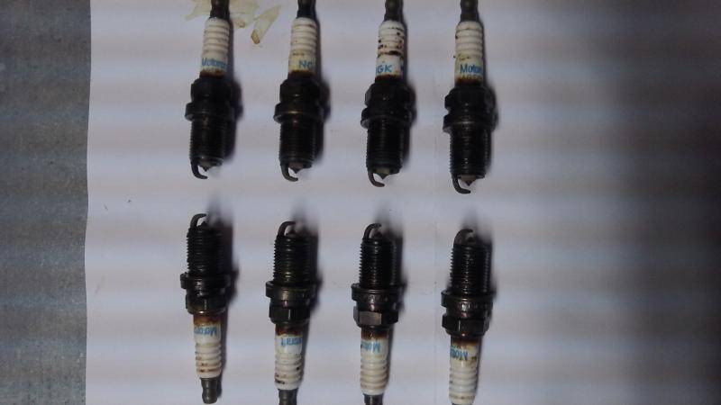

Bottom line is that the car never threw a misfire code until we put up with the 'fail safe' engagement numerous times. After the first rounds of FailSafe we took the car to the dealer and they stress tested the coils. No problems.
Two weeks later, it went into fail safe right after starting then ran poorly even after a restart. Took it back to the dealer and #5 coil threw a misfire code and was emitting RF interference. All the previous throttle body codes were invalid.
We are having them replace all the coils. Most of them at our cost.
