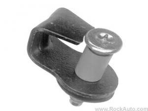

Why are you removing the striker plate?
See attached.
Joe.
Is that pic you posted what you are replacing? Cause if so you just turn that torx head bolt that runs through the center of it. :cool:
There are a few Torx head bolts on the car.. (sometimes called star-head). I think the largest of them hold the seatbelts to the floor.
They are one of a variety of a tamper resistant bolt-head designs, preventing less skilled people from loosening and removing bolts.
Manufacturers don't want doors flying open or seatbelts detaching during a crash.
Get a set at a local cheapo-tool store. A 3/8 socket set might be best for the bigger bolts.
Tiny ones are useful for some home appliances.. cell phones.. computer hard drive cases.. various things.
