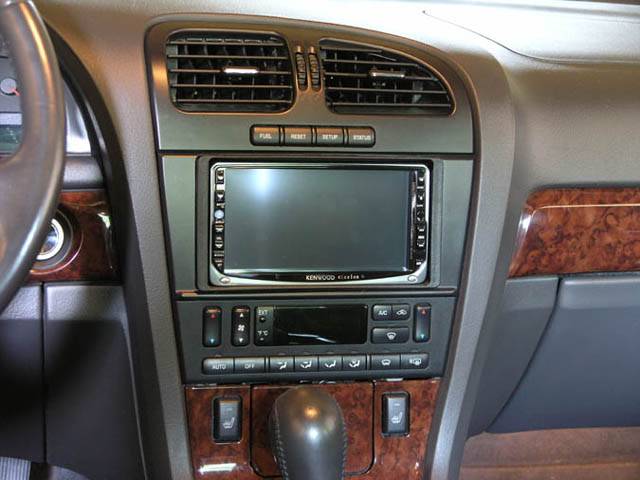

I used the face off my dead factory HU to do this. PIA, but curious if anyone has a different idea.
Another idea we used was using two separate faceplate kits, one a LS single din and a ford explorer double din. I cut out the single din LS kit until the double kit for the explorer would fit into the cutout. Then use a lot of glue that specially used for abs plastic, build up and strengthen the the two joints with glue and sand down and we used a bumper repair kit from napa parts store to fill in the seam and sanded till smooth. and painted to match original Factoy head unit. Didn't come out too awefully bad, but an idea if you want to try it.
I just started another thread on this! I should have looked better. OLLY00...are you saying you used the face plate off of a factory Nav unit? That really looks nice! Did you have to modify it at all? Do you have the screen size of the Kenwood unit you are using? I guess I need to make a call and see if the face plate is available separetely. What are the chances of that....
Sorry for the delay, It's been a very busy week. This is not the face from factory NAV all though it would probably work. I removed the factory face plate from the standard tape deck unit that comes with the glove box CD changer. We used a drumel tool to cut out the opening (very difficult) so the standard double DIN install trim ring would fit. We were tring to make it look as factory as we could with what we had to work with. I believe the screen size is 6.5 inches.
