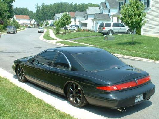

Guys,
I have been going through battery hell with my 98 Mark VIII LSC lately. I have gone through 3 Optima Red deep cycle batteries in the period of a month. After recently sensor lowering my car, I have been having this issue. The problem kept happening after I let the car sit more than 3 days. I would get a brand new battery after autozone stated the battery was depleted. I would put the new battery in and whamo the Mark would start and be fine for as long as I drove it at least once or twice in a 3 day period. But if I let it sit for three days or more the car would be completely slammed (dropped) and the battery would be drained. I would try to turn the car on and get the click click sound.
It gets even more bizarre. After sensor lowereing the car, the car front end would always be slammed and the compressor would have to get it back up to the level I set it, but then when I would hit highway speeds I would get check the air ride system. And then the car would stay slammed in the front, until I would turn the car off and restart it again and the compressor would kick in and get it back to the level.
I am wondering do I have bad height sensors in the front because the rear just seem to follow in step in with however the front responds. I have brand new solenoids from Arnott, and get a new sensor from ebay for the front of car since the driver's front always seems to drop a bit lower and I would hear air hissing from that side. So, I guess do I need a new air struts in the front or just what? Should I convert to the coil suspension. HELL guys, I just need help as to what to do and to figure out why I am going through batteries like this and I want my car dropped just and inch all around since I have nice 18's on the car.
Well I know I have come to the right forum, so my Mark VIII friends, please HELP A BROTHA OUT!!!!!
