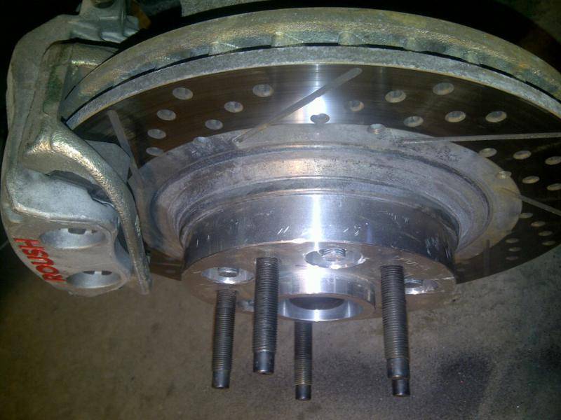

Driller;
Nice looking set there. i don't have Roush anything on my car. it's completley stock, so i dont know if those rotors you have there in the pic will work with my stock factory calipers? if they would, where did you get those? the size? could you provide a link if they will work with the stock caliper? and i do have ceramic pads on the front now. metalized pads in the rear, late last year.
The car has the Cobra hub swap and 'Rousch' branded PBR calipers with Baer rotors - I think they were a Mustang GT front brake upgrade kit. Pricey to be sure but Baer rotors are some of the best available. The rear has the stock caliper on another set of matching Baer rotors with the hub swap and caliper brackets for the bigger rotor. Stainless brake lines complete the package.
Link for the rotors... http://www.decelarotor.com
The only way these rotors would work on a stock Mark VIII would be to drill them to 5 x 4.5 pattern.
EDIT... to my surprise, Baer does offer their Decelarotor design to fit the stock Mark VIII. ;)

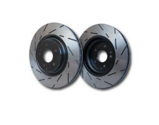

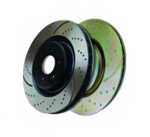

I just put EBC MarkVIII in the EBAY search bar and these came up on the page. They were selling 2 rotor or 4 rotor sets so I just grabbed some picks of slotted/slotted dimpled EBC's
