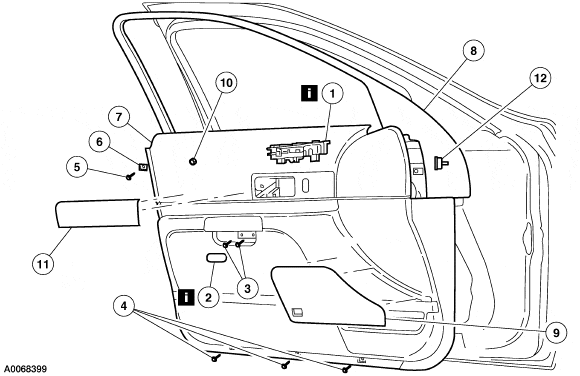

i unscrewed the 3 screws on the bottom of the door and the one on the side. ive also unscrewed the two screws underneath that plastic flap by the door handle. there arent any screwes left and my door panel wont come off!? what am i missing guys? thanks in advance for any assistance.
Go to the top of this page: Click on SEARCH key in door panel removal and narrow the search to Lincoln LS. There are a few threads covering this. All you need to do at this point is to pop the fasteners with something like an screwdriver.
If you cant find something let me know, I think I still have directions Crutchfield sent me.
Item Part Number Description
1 23942 Window regulator control switch panel asembly
Removal Note
2 23A742 Screw cover
Removal Note
3 56914-5424 Screws (2 required)
4 N806555-S424 Screws (3 required)
5 W504246-S424 Screw
6 239A04 Screw grommet
7 23942/23943 Front door trim panel
8 20890/20891 Front door window garnish moulding
9 601B48/601B49 Speaker grille
10 — Nuts
11 238A70/238A71 Door trim panel applique
12 W708599-S Push pin (9 required)
