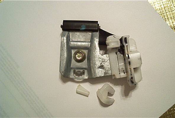

I have a 2000 LS6 and all of a sudden the driver's door window stopped working. I think I may have caused it when the window was frozen shut a couple times this winter and i keept trying to force it with the switch.
I can hear the motor operating when I hit the switch. The window goes up but not down. I pulled the door apart and saw that the window bracket on the left had one of the track guide prongs that keeps it moving on the track and the guide ball was no longer in the bracket (image attached). The window was no longer in either of the channels. Apparently they lost their seal. The broken one wouldn't move at all but the one on the right would move up and down.

It sounds like you need a new regulator. There is no adhesive used to hold the glass to the regulator, it's pinched in. The dealer or junkyard are your two options - I recommend dealer.
Your picture confirms you need a new regulator. The plastic part is a known issue. Expect to pay about $130.

The regulator is the part the motor moves to move your window. I had the same prob with mine this winter the same piece broke and I just changed the window regulator that I picked up from the dealer for about $100 you cant just replace the "channels". you have to replace the whole thing. :monkey:

I got a new complete regulator for the driver's door, motor and all, for $88 including tax. My girlfriends mom works at a Ford dealership. It was originally $125 for the whole thing.
I decided to just replace the whole thing instead of just that one part.
