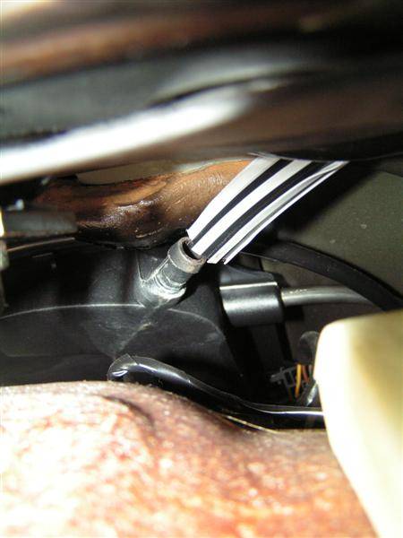

It worth it to take a look at the drains. No cost and that is most likely the problem.
I have found the lines seem to shrink and you might need to add some hose but usually you can pull and force the hose back on the nipple. I added a small hose clamp to keep it from coming off again.
On mine had this problem solved with small stainless hose clamp . Also a good idea is to get piece of weed wacker line and feed down the drain every so often to make sure they don't get clogged. Clogged drains are a problem I have had with most of cars I have had with sun/moon roof . Seems like some tree or flower pollen tend to clog them. My Mks does not have one which was a plus when I purchase it
