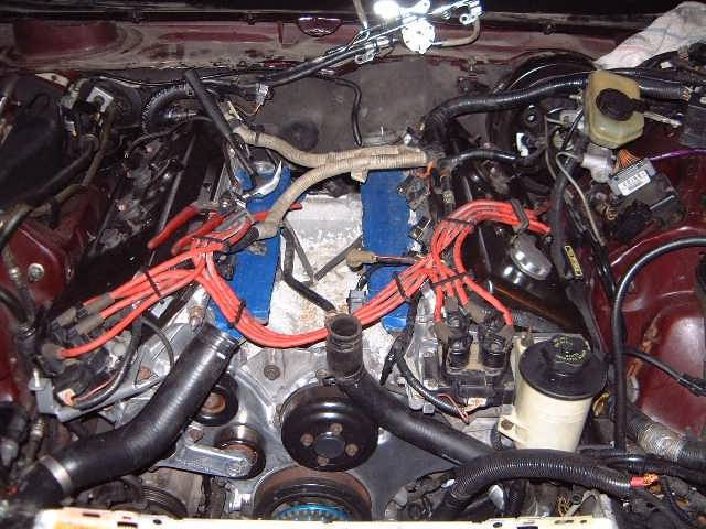

The plastic part is the reservior, but you do not remove the plastic part from the actual brake lines below it. What you are doing is removing the brake lines/reservior from the big black brake booster by removing the two nuts/washers that secure the reservior/brake lines to the booster.
Actually if you look closely at the pic that I posted you will see that the reservior/brake lines are seperated from the brake booster. That is what I am referring to. You will notice that the reservior/brake lines are connected as one. No fluid will leak out if done in this manner.
Hope that clears it up a bit more.
