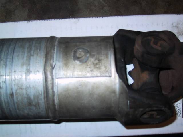

Anyway, when the car was up on the rack, I did get a good look at the driveshaft. It was a little alarming.
1. It looks like there are score marks, etches that go around it in a few spots.
2. there's a noticable BULGE in the middle.
It doesn't look twisted, but the middle is bulging and there are some lines carved into it.
Should I be concerned?
I was just told, privately, that this was the normal appearance of the '93 driveshaft. Does anyone have a picture of one?
the scores that u r seeing in the driveshaft is from a wiring connector that is very close to the shaft.. this happened to mine also it will throw ur balance off a bit mine i can feel when im doing betwen 75- 90 then it goes away
That little bit would never affect the balance at all.
It is totally normal the way it looks. They are junk.
You need this if you have vibes.
If you don't then leave it alone and you will be fine.

Those scores are radial in nature meaning it has removed the same amount of material all around. It will not affect the balancing. It could affect the sctructural rigitity of the unit if it went on long enough and deep enough.

About the Driveshaft, I have a '93 so it looks like I have the one piece unit. The bulge seemed to look like it was flaired in the middle, like an internal bulge...
I'd better get it up on ramps tomorrow and take a picture...

From my '93...
The 'scoring' is from loose tunnel insulation. Should be nothing to be concerned about. The bulge is factory spec. :p
I sold mine to a Gen2 owner who had bad vibrations and it cured his problems. Meanwhile an MMx shaft cured my vibrations from the 4.10 gear install. Go figure.

Thanks. I figured that if anything was really wrong, the Mark VIII would vibrate like crazy, but it did look a little alarming. I'd never really noticed the driveshaft before. Those pics were incredibly reassuring. Thanks again.
