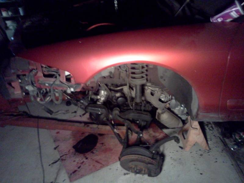

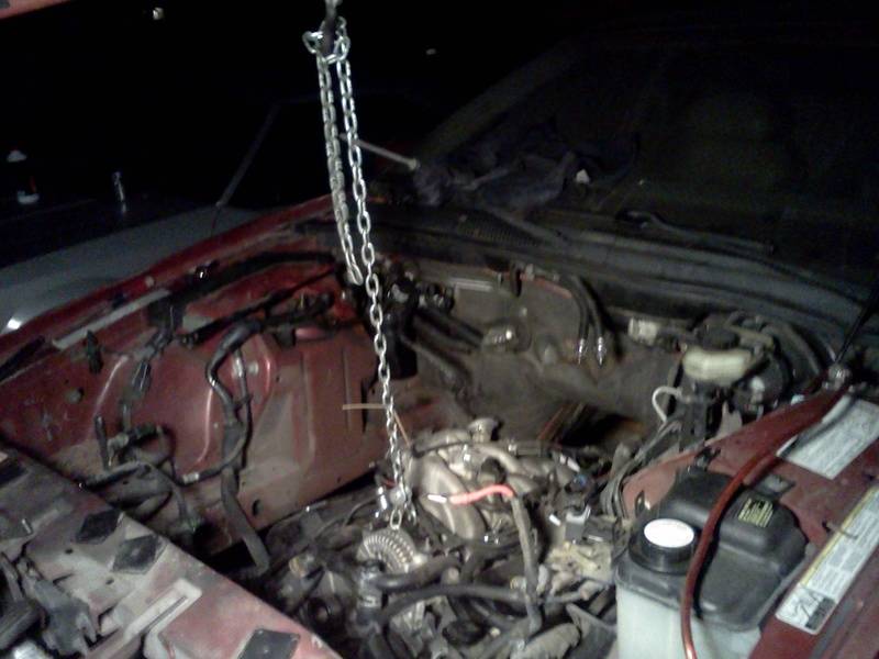

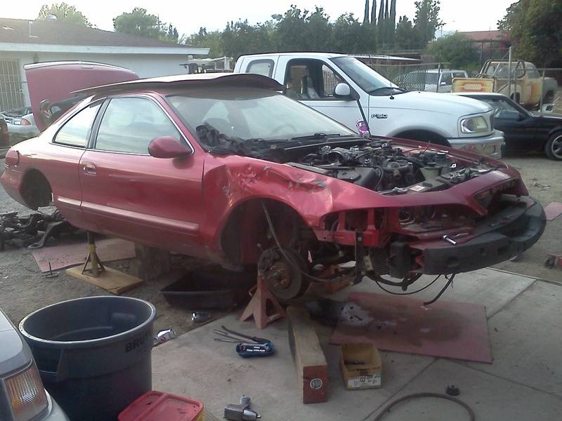

Here are some pictures of the fun
I apologize for what may be big and lousy pictures....
this is the end result. It's sitting on the car. It was still over 100 degrees outside, and we got lazy. We'll roll the engine out later this week.
Great job. That will run great in the 88 stang! You really should have came on here and bragged that you did it in 39 minutes and even took a piss break. LOL With that engine you should run well into the 12's N/A.
