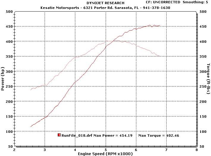

Dynoed at 454 hp

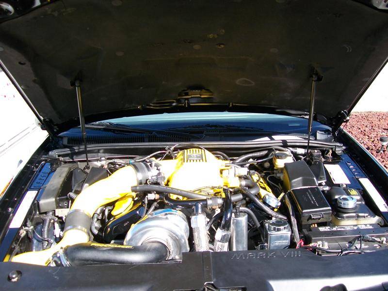

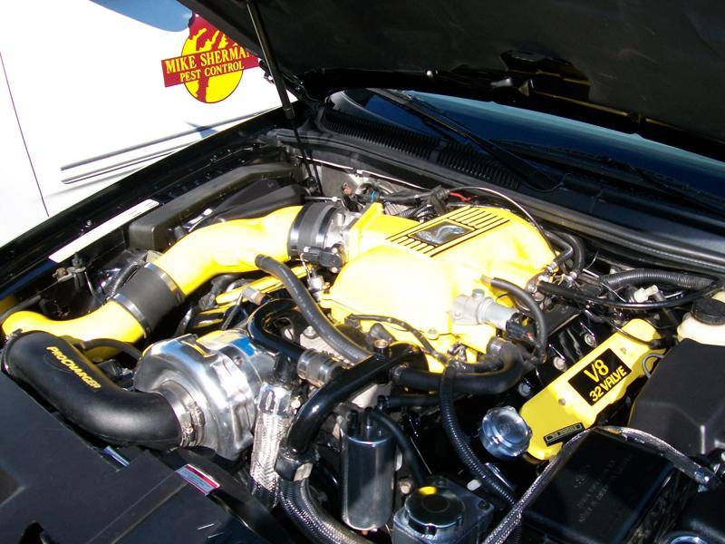

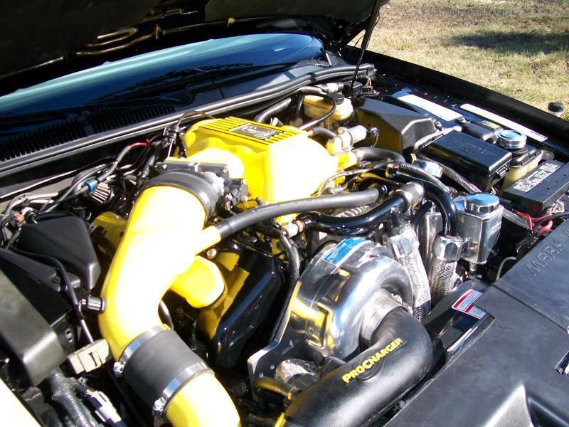

BLACK SNAKE
Sep 11, 2007
158
bradenton
* Aluminum 4.6 Teksid Block
* 2005 Mustang GT crankshaft- polished and race prepared
* Mod Max 4340 Forged H-Beam Rods w/ ARP 2000 rod bolts
* Manley Platinum Series forged flat top pistons
* Rotating assembly balanced to .5 grams
* Livernois Beehive valvesprings
* Crower stage 3 cam shafts
* P1SC procharger
* Kenny Bell boost-a-pump in addition to SVT Focus pump
* IMRC plate delete
* 60lb/hr Siemens-Deca Fuel injectors
* NGK TR6 Spark plugs
* Lincoln Motorsports Race Mufflers
* Custom off road x-pipe
Crank or wheel? I would love 454hp. Sold my novi1000 kit. Bummer. Fill in with more stats when you get to track.
Nice numbers but why the 05 GT crank? It's not any stronger than the stock Mark VIII cast crank...
WOW, Is there any reason to use the GT crank rather than a Mark VIII? How much boost? Are you using a inter cooler? Thanks Don
How do you like the P1SC? What kinda boost level are you running? Stock heads/cams, correct?
I see that's an uncorrected dyno, but since you're in Florida it probably wouldn't have changed much.
The ford gt is a boosted engine. What better crank then one that is bosted.
boost
I am running 12lb of boost and the reason for the crank is the builder likes the strength.No I haven't been to the track, still breaking it in. I like the p1 , if I were drag racing it I would probably get the D1.
454 HP at 12PSI and 6600RPM? That's winding the hell out of that 4.6 to make that power. What's the CR? 5:1? :lol:
And what's up with all the dips in the power lines? If you're using a smoothing correction of 5, I'd hate to see what the spikes and dips would look line non-smoothed.
Your torque curve doesn't look very impressive, either. It's peaking peaking at 5000 RPM and starting to fall on it's face almost instantly, by 5400. Your torque curve really is a curve.
Personally, I'd be concerned about all the dips and bumps in those power lines.
What was your AFR? What gear did you do this pull in?
I think you've got some other issues going on there. I know guys with Prochargers like yours that are pulling 500+ HP out of 8 psi.
Don't expect great (quick) times at the track with the way that motor is making that power. Unless you plan to launch at 5000 RPM and keep it between 5000 and 6500 RPM for the duration of the 1/4 mile run.
