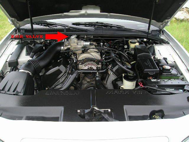

Can any one tell me about what the EGR is and where it is located in the engine?
EGR is acronym for "Exhaust Valve Recirulator". It takes exhaust gases and recirculates them into the intake manifold. The result is a slightly lower combustion temperature that reduces "NoX" emissions.
See pic:
