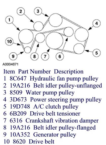

Took the serpentine belt off my 2000 Lincoln LS V8 at lunch break and don't have the pattern as to how it goes back on . . . I know I'm an idiot! Can someone help me out with this ASAP! If someone has a schematic they could provide that would be awesome.:confused:
belt routing
Belt routing for 00-02 V8
Yep the belt is huge and there is no schematic in or on the car. For all those attempting this be aware it is very very tight! Now that I've done it, it will be easier the next time. And the tensioner is super stiff! Had I done it at home in my garage it would have been a cake walk! Just givin ya'll a heads up! Thanks again Quick!
