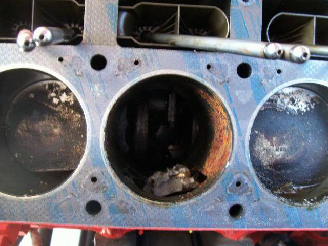

I agree with the rest. A blinking CEL means there is a catastrophic failure with the engine. The last time I had a BLINKING CEL, this was the 5000 dollar problem I found:
TOW your car to a repair shop. Incidentally, this was a 4.8 in my Chevy truck, not my LS.

Yeah, bit of a mistype on my part, thanks. Should have said high probability of a catastrophic failure. Still and all, when my engine dropped a valve into the chamber it was immediately followed by a blinking CEL, which of course was quickly followed by an engine shutdown.
In any event, I think that we can agree that continuing to drive with the check-engine light flashing can (and probably will) get very expensive.
The flashing light indicates that there are fairly severe misfires going on. This means that gasoline is going into one or more cylinders and not getting ignited. This raw gasoline quickly gets pushed to the catalytic converters where it will ignite and melt them. Also, you could get enough raw gas in the cylinder(s) to wash the oil off the rings and cylinder walls and do damage there as well.
