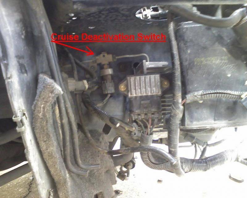

Have you checked the condition of your vacuum lines? Also check the little rubber elbow that goes on the air tube by the passenger side valve cover. Ive had those cause random stalling too..
As for the cc has the recall been done?
If not do it.
If it has been done in have had to replace 2 recalled switches.

In front of the passenger wheel
