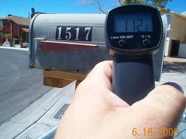

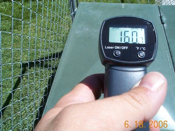

OK, so what is normal operating temperature for a mark VIII? Mine got to around the (R) today and my infrared therometer had it about 215 degrees. This was at the front of the timming cover. Thats the hottest spot I could find. Does this sound like a normal temp?
Today outside around 2:00 PM I pointed it at the street (asphalt) and it was reading 155 degrees!! The actuall outside temp in the shade was around 106 or so.
I will wait until it goes up higher next time so I can check it again.
Oh yeah, I'm sure that Dr. paul could add another 5-8 degrees. It's even hotter there!
