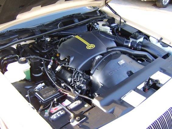

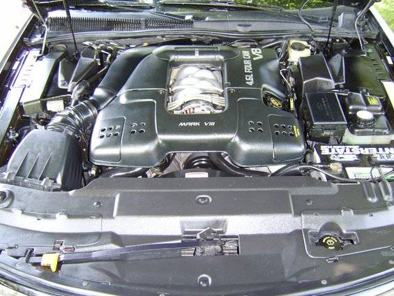

My Mark's engine bay looks pretty nice overall:
But it doesn't hold a candle to my Marquis:
It's virtually spotless, and I really pride myself on keeping it that way. As I tell everyone who asks me how I keep it like that on the panther platform forum I frequent, regular cleaning is the key. It gets a wipe down with the wheel/tire wash mitt and bucket every time I wash the car, and it really helps to keep the dirt and grime under control between the major details.
