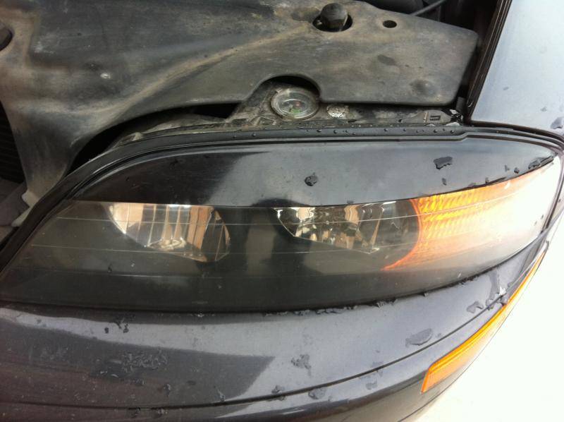

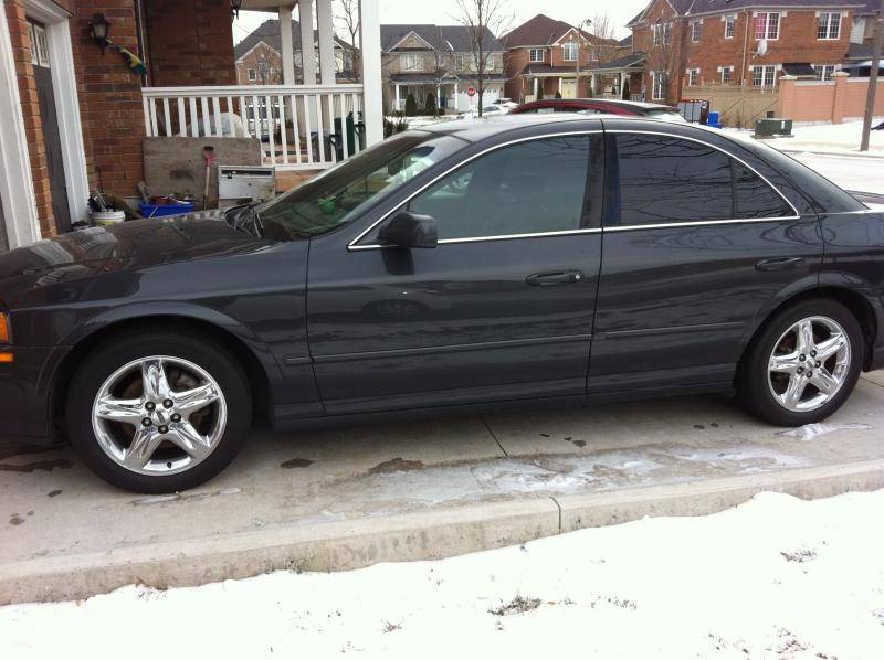

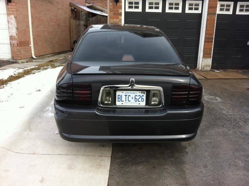

my lincoln
this is my 2002 Lincoln ls v8
hopefully ones of these days i can start or attend a LS meet in Ontario or somewhere in The States
