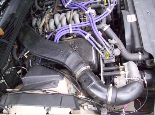

I just fiberglass wrapped the stock intake tube with good results. To me and some others getting fantastic results these 1st gen cars do not need a cobra intake.

If you put a spacer in the sub frame you will clear the pulley and have no problems with the stock hood.

You have never seen a centrifugal supercharger before? lol They are by far and away the most common for aftermarket blowing. Its the better way to go on a Mark because you can add an inercooler. A twin screw or roots style is more fun due to the instant torque but there are no intercooler provisions for them and positive displacement blowers are just big heat pumps. Centrifugal allows for more power and boost and are more effecient as well. That being said, having all the power at 1200 RPM with a twin screw is just so intoxicating. Just wish I had the skills to fabricate an intercooler.
As an alternative you can swap to C heads and do a Cobra setup and have a crap ton of fun.
Here was my last real Mark build. Car was just a spectacular machine and I miss the hell out of it.
