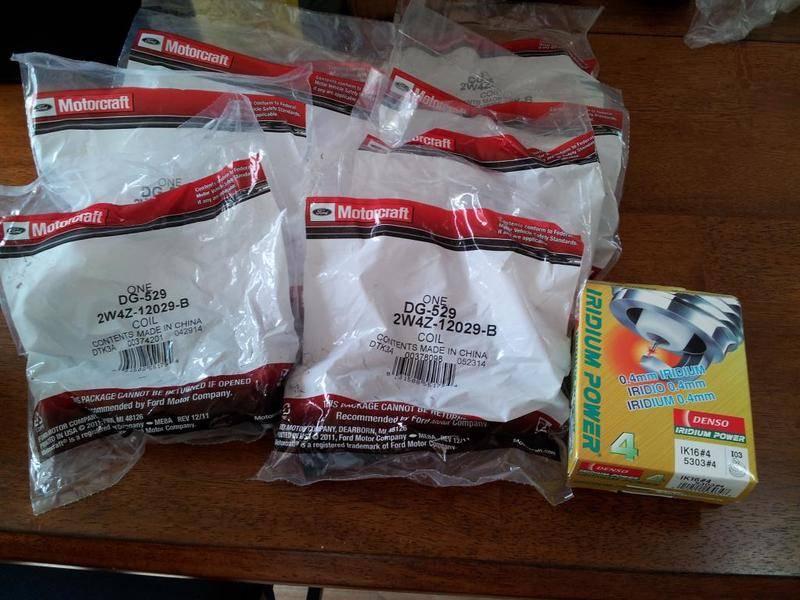

Parts are in! Motorcraft COP's made in China :shifty:
Made in China is not always bad (for the consumer). Ford should be holding them to some sort of quality standards, unlike the Chinese knock-off parts.
I hope so - just got the project done (a little easier the second time - 1st time was just plugs) and she's running smooth - thanks for the input
