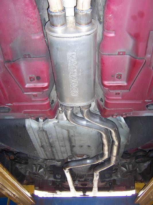

Here's a pic of the 2 in 2 out Magnaflow in stalled.
Calabrio said:
I've heard one complaint about the Mark VIII's exhaust note is due to the fact the mufflers are so far in the rear of the car. By using the dual in/out in the middle of the car like this, I wonder how much this affects the tone?
Does not affect tone! The way I describe it is a very Mature car sound. Does not sound like a Mustang.. but sound like a Mark VIII should. Subtle but yet a rubble that says I bet you wish you had a V-8.
