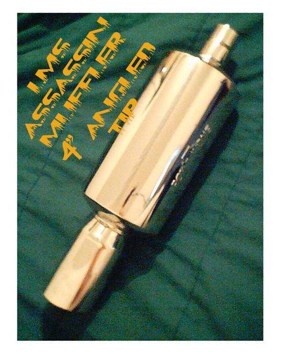

The Assassins are what was on my green car. I have some pix of them floating around....I will post them. They are a straight thru design with packing. I loved the sound of them on my car. :Beer
I never sleep.
The Assassins are a straight through design that in 3 and 4 inch really pump out some serious cfm's.
The fitment on that car would be tough because the round style bodies on the larger internal versions are huge.
They are perforated tubes inside with angle cuts in each perforation to catch the passing exhaust gasses without any real restriction. There 100 SS too including the ss wool packing.
