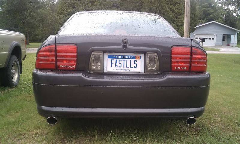

Here is what my 4" tips look like. I personally like them cause they fill up the cutouts nicely.
