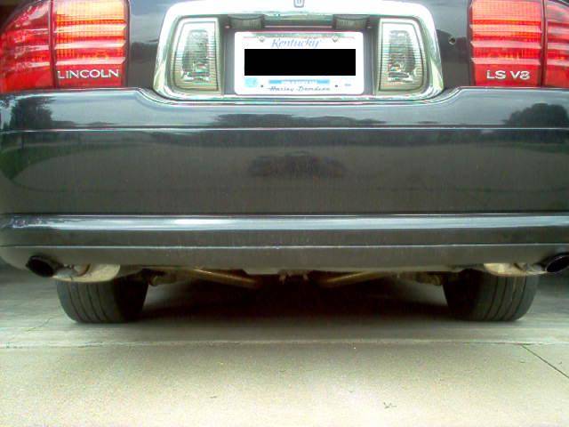

SO this exhaust I have has been bothering me. I have noticed that it seems to be off just a tad bit. The passenger side muffler seems I little higher up and farther out than the drivers. I'll show pics of what I mean. Could it just be that it was installed a little off? Any help is appreciated...pics comming in like 10.

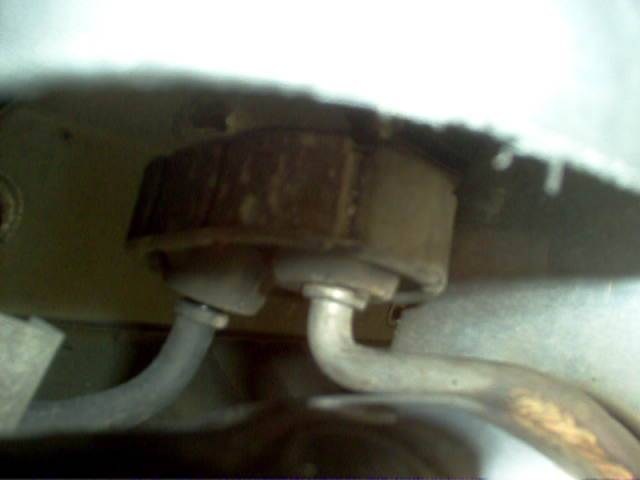

First is of the rear veiw, and the other one is what the hanger looks like. I think they didnt line it up right or something. Can I change this myself? Help guys!
looks fine to me from the first view.. why dont u take a step back and take a better pic of BOTH exhaust tips.. maybe something from the side so we can see if one is sticking out more than the other..
The exhuast can move around a little, you may want to give those tips some more clearance.
I think he's talking about the difference in the way the mufflers hang, one a little lower than the other. You can probably tweak the hangers to try to get them perfect. Bending one slightly up or the other slightly down.
Mine was like that and I put in new hanger donuts and had the muffler shop bend the hangers a bit. However, once you put exhaust tips on you can manipulate the system all you want.
The hanger on the left seems a little out of place, making the left muffler a little bit lower, that's what it looks like the problem.

I had the exact same problem. I had the custom 40 series exhaust setup done and I just took it back to the place that did it and had them redo it. They did it at no charge.
