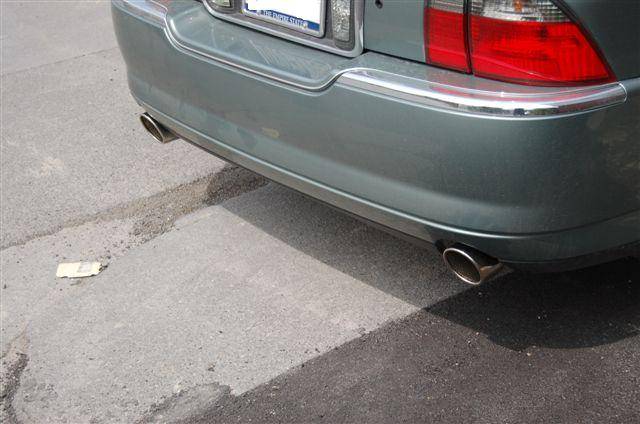

I didn't like how the tips were short of the bumper by 2 inches.
I guess the jag S type has a shorter valence than the LS.

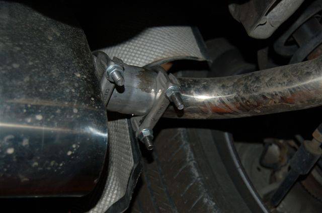

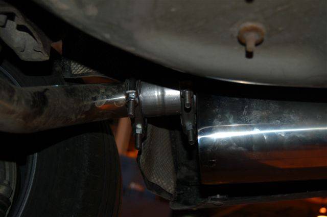

I took a sawzall and cut the pipe going into the muffler about 2" out then reworked the hangers again with a torch.
Got some 3 1/2" 2" inside diameter couplers and some 2 1/8" clamps from Autozone which allowed me to remount the mufflers

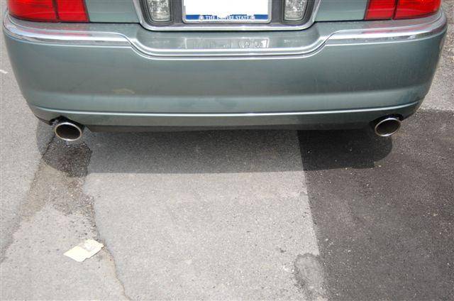

so the tops of the tips are even with the valence.
Looks a lot more badass with the big tips visible from the sides and the note is much less droning now than it was before.
I've got about 500 miles on my mufflers so far.
Only got the driver side done today but will do the other one tomorrow and post some back and side pics.

I'm much happier now that I've extended them 2 inches.
My driver side had moved before and melted the valence a bit as can be seen in the pic but I can fix that up later as I used to be a bodyman.

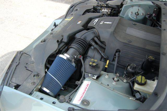

I cut my stock airbox down and put on a 40.00 Autozone filter.
I like the large size blue over the smaller K&N.
