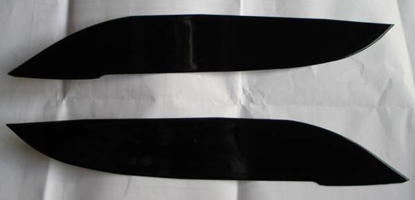

I do own a 2003 as well, i did a trial fitment before i had them painted they seemed to fit well. Here's a pic:

Yeah, those are for the 2003 and up LS's. They will NOT fit on the 2000-2002 headlights. That's why I've worked with the manufacturer to make the correct style. They look real good once on. Take some pictures when you get them installed.
