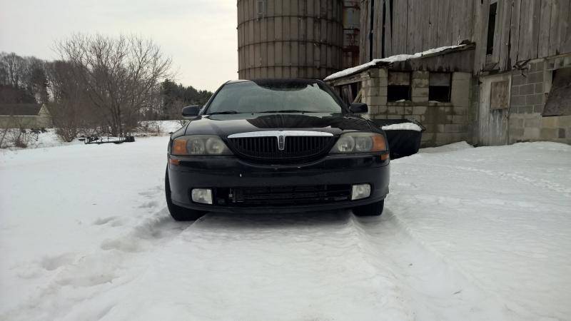

I am starting this thread for keeping track of my own progress on this car and for anyone that would like to follow along. I always appreciate helpful advice and constructive criticism (even destructive criticism....as long as it's funny). I picked up this 2002 V8 Sport for only $350 and, overall, it is in great shape for the year and mileage (180k). My plans are to get it into daily driver condition first, start improving the looks and then adding here and there for performance.
Of course the cosmetic things are easy to spot:
broken side mirror
passenger window regulator
lower front fascia is cracked
some door dings in the body
Items to fix for DD status:
hydraulic leak for cooling fan (fix or replace with electric)
replace plastic cooling system parts - flush system
VCGs, coils, plugs
fresh oil
check timing chains and tensioners while doing VCGs (should these all be replaced simply because of age and mileage?!)

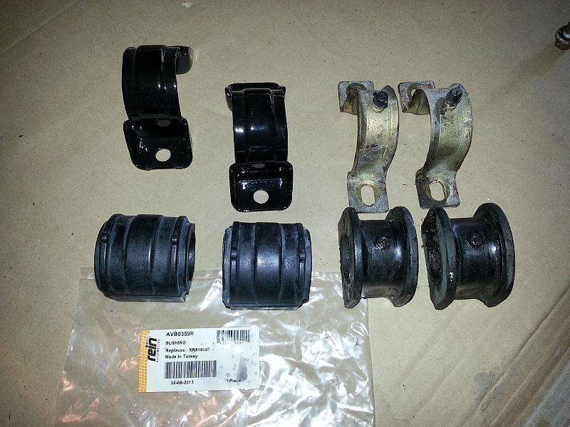

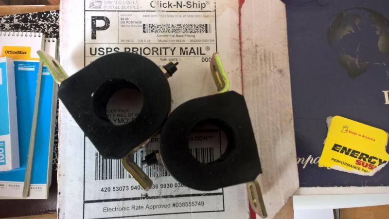

Suppose I'll do sway bar bushings since I was still hanging on to these from my '02 LSE. LSE and sport both had the larger sway bar, correct?

LSE was an appearance package only. It did not alter any suspension or powertrain components.
The BASE FRONT STABILIZER BAR, LS6, 29.5MM
The BASE STABILIZER BAR, LS8, 28MM
The SPORT FRONT STABILIZER BAR, LS6, 32MM
The SPORT FRONT STABILIZER BAR, LS8, 31MM
The BASE REAR STABILIZER BAR is 13 mm LS 6 and LS8
The SPORT REAR STABILIZER BAR is 18 mm LS6 and LS8
Found this through search. So looks like I'll need a different set of bushings after all. Thanks for the heads up on that joegr! So LSE is a prettier base model and sport is sport.
What's the part number on the bushings that you have?
LSEs are Sports models with the LSE appearance package.
See, that's what I had thought. Joegr's comment just threw me. The way it was worded made me think I was remembering it wrong.
I'll have to see if I even have a part number. Will I not be able to properly measure them since they are rubber and maybe slightly compressed in the bracket?
Yeah, I thought that you could only get the LSE package on a sport. In any event, the real question is if the bushings he has are the right ones for the LS he has now. (They might have been wrong for the LS he had before too?)
I'm gonna take a guess that these are Energy Suspension bushings and therefore wrong on any LS.
Falecf4: if they are ES bushings, they are too narrow and let the bar slide side to side. You can try to use some cylindrical clamps or, assuming you have the original sway bar with separate bushings and brackets, you can find Jaguar bushings.

I don't think there's any need to replace the tensioners or chains provided you have the updated metal ones. Given the year and mileage, if it didn't come with them, they probably have already been replaced. Hopefully, with metal. But then again, some sellers are still selling plastic tensioners new on eBay for $120, more than twice the price of the metal parts
Anyway, maybe you and Izzy can be friends with your truffle butter interiors

This is where I got my bushings. S type bushings, works for Sports with the Gen 1 style sway bar with removable brackets and bushings. Rein XR819697 https://www.fcpeuro.com/products/jaguar-suspension-stabilizer-bar-mount-xr819697
However, there is a chance you have the updated molded-together bar from Gen 2 if it was replaced at the dealer.
Tensioners: If you have the time, I'd open the valve covers first to see if you need them. I ended up never using the tensioners I bought since both my original and replacement '02 engines already had the metal tensioners. I got them, along with the chains w/ master link, from Chris' Foreign Car Parts. He has a website and an eBay store. I guess I should think about selling them at this point since I doubt I'll need them
Yup, the ES bushings are too narrow and should not be used on any LS. Unless you don't mind some play in your front end sway bar.

... they like to slide side to side on the bar because they are too narrow. The solution was to replace worn out bushings on a 1st Gen SPORT with Jaguar Rein #XR819697 30mm bushings from FCP Euro, which are an identical fit and one ends up retaining the stock bracket.
The 00-02 bushings aren't in service any longer anyhow, they'll offer to sell you the latest front sway bar with the molded bushings on them and when that stock depletes, only options left would be ES bushings or Rein 30mm for the Sport models.
For the front sway bar bushings I can not recommend the Universal fit Poly bushings from Energy Suspension, they are too narrow and will not seat correctly. Save the old brackets and put a set of Jaguar Rein #XR819697 in, that is if your LS is a 1st GEN Sport which needs the 30mm bushing.
(note that if ordering from there, you have to order qty 2)
