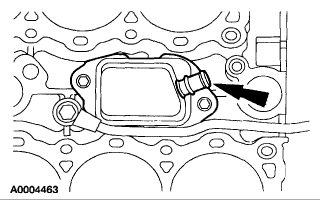

Clogged PCV system? Fuel filter?
how would i check for a clogged pcv?
If it hasn't been serviced it probably needs attention. The isn't a conventional valve.
From Alldata......
REMOVAL
Remove the lower intake manifold.
Remove the Positive Crankcase Ventilation (PCV) valve from the oil separator.

Lets make a note here that's on a V6
