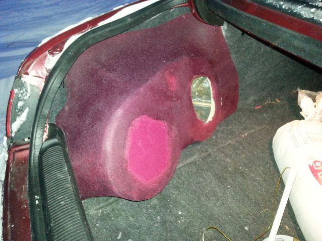

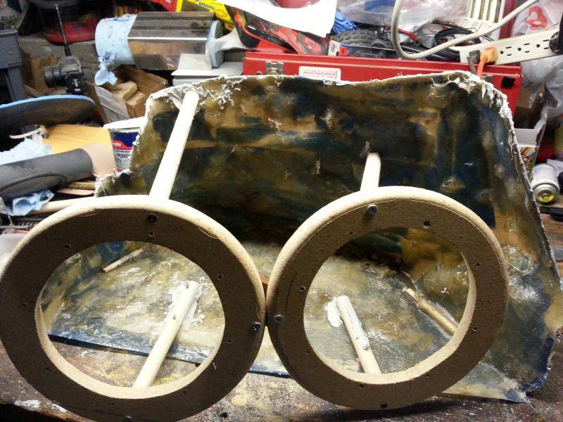

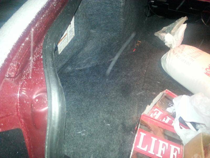

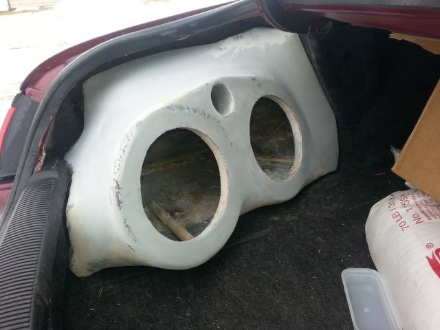

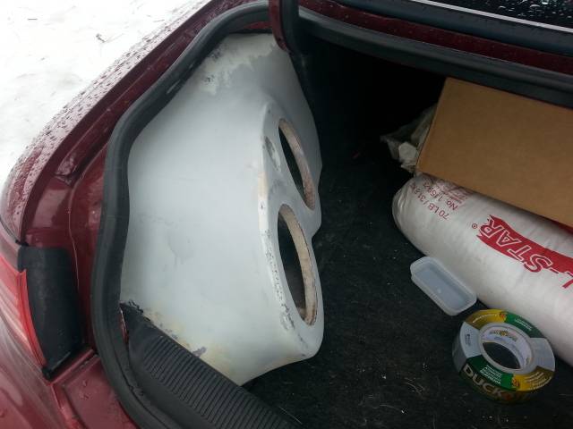

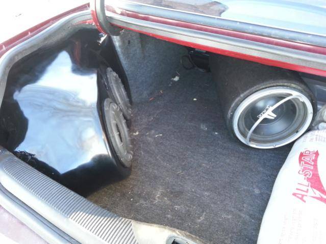

So I had an 8" sub layin around that I wasn't using. So, I figured it was time to order another one and put them to use. I have 1 10W3 JL sub in a tube box now, and it sounds great for me. I have built many systems that were big & loud, but now I'm getting older and I don't need that. In fact, my 1 10" sub takes up more room than like. That's why I decided to start this project. (that, and I was board) If this set up doesn't sound good when I'm done it will be sent packin. This is my first all fiberglass enclosure attempt. My plan is to tuck the subs out of the way as much as possible. Its going to go in the rear corner. Even though it covers the air ride door it easily, with a little pressure, slides right out. It holds in place nice and snug though, so it won't slide around.

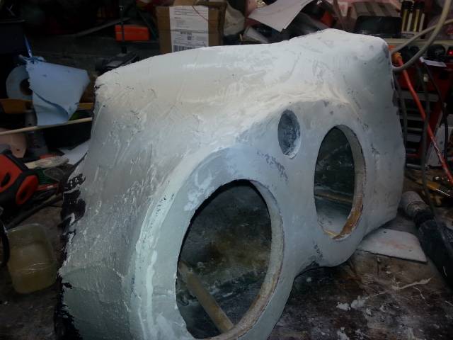

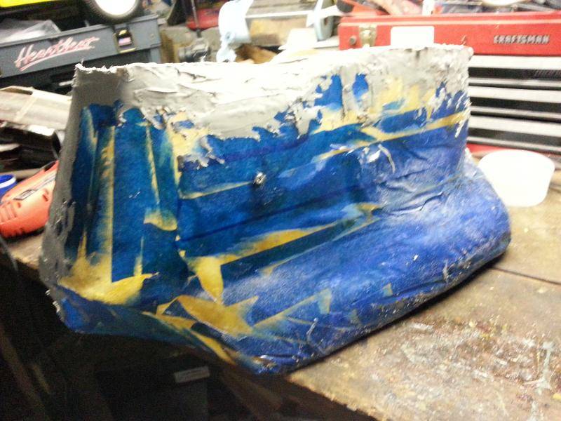

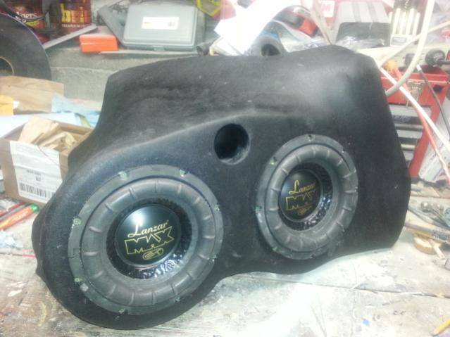

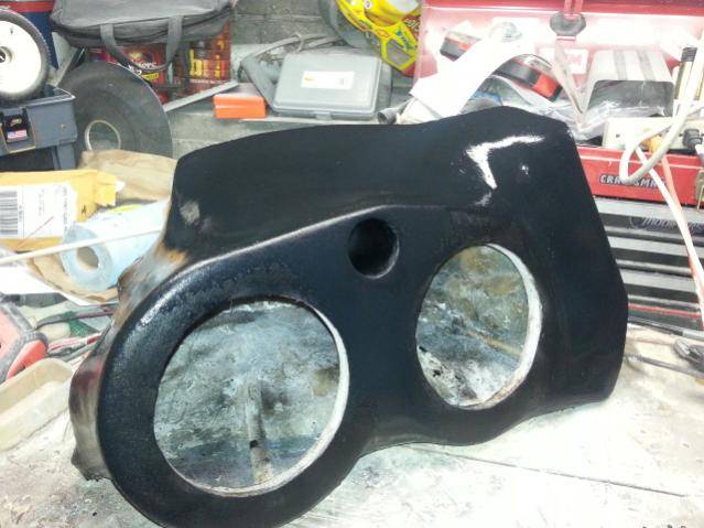

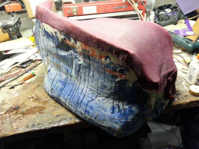

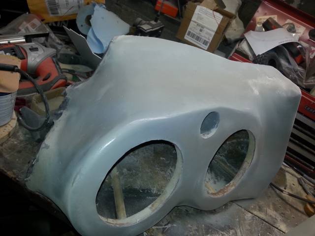

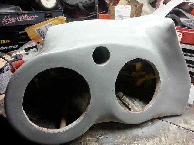

More progress. Time to start with body filler and sanding.
Thinkin about runnin one inverted to give me more box volume.

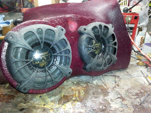

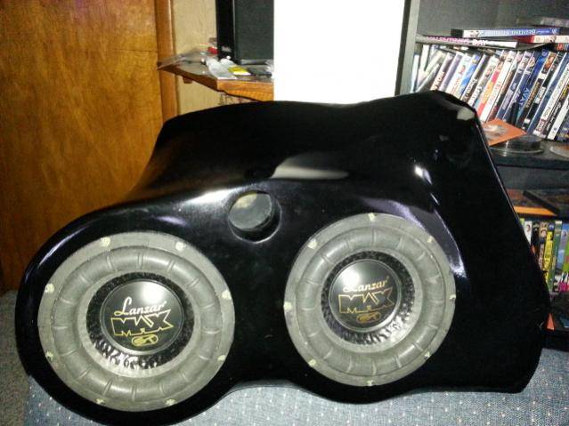

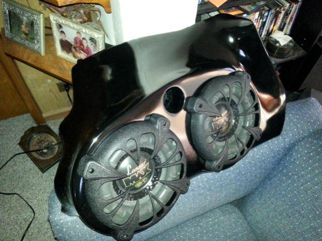

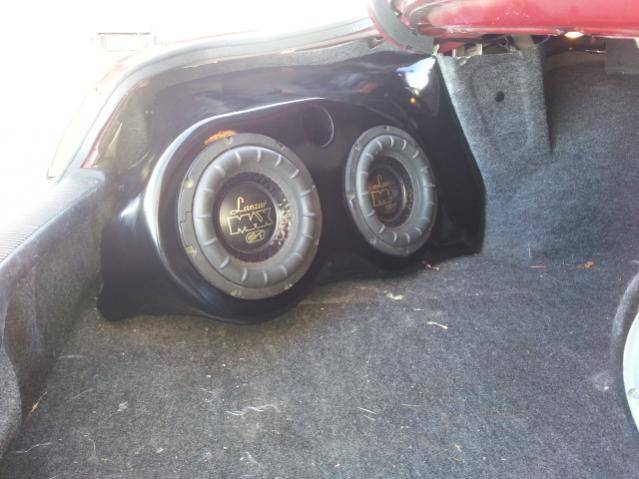

Needs more port....but looks good none the less and those lanzars really get down for the price
I like the standard mount with the grills off look the best.
I really like the placement too, good job.
If he needs more he could just invert both of them if the rear sub will clear the trunk hinge. But yeah, those are good bang for yer buck subs.
Thank you.
Unfortunately the other sub just barely clears the hinge with the grill on so inverting it isn't an option.
I also prefer grills off but I use my trunk, and my wife will drive my car from time to time, and she will throw groceries in, that slide around. Thats why I bought what I think is a decent looking grill. Not just an old waffle grill.
You do some fine work. Looking forward to seeing the final product.

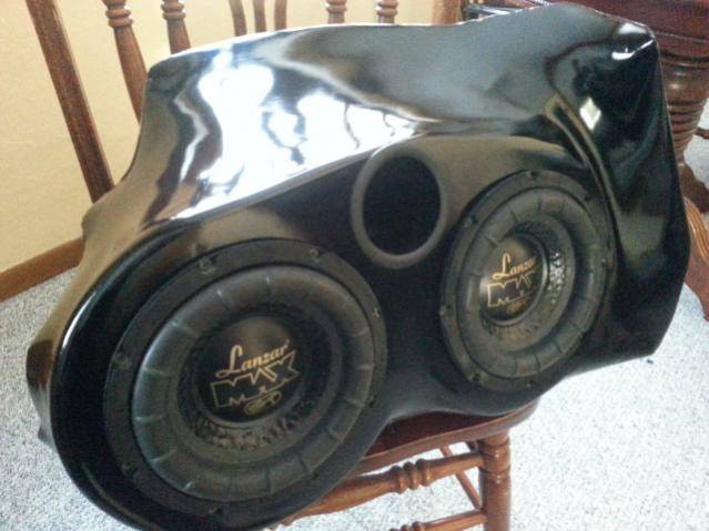

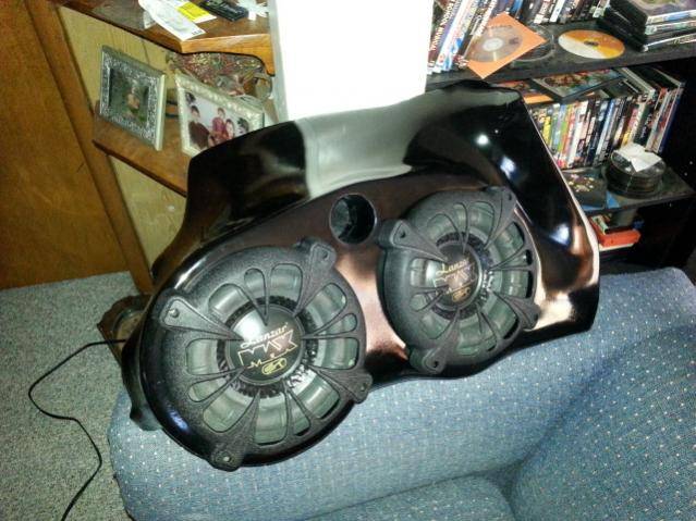

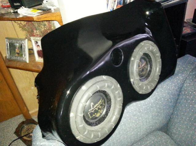

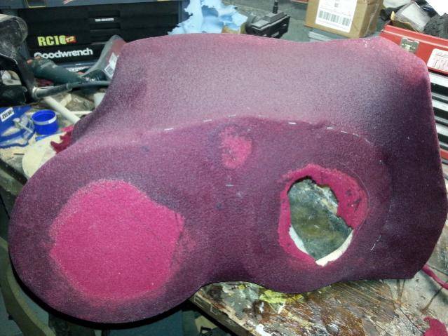

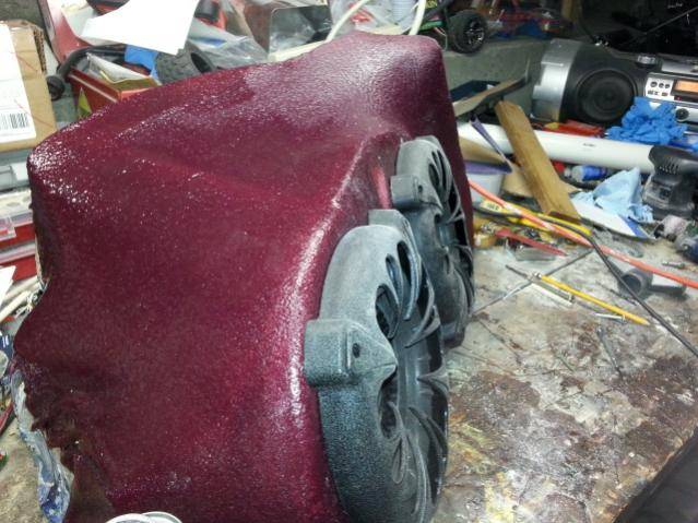

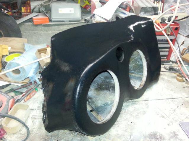

Well... I didn't like how it looked after the bed liner coating dried so I did a BUNCH more sanding.
Dam!....That looks excellent! nice work Robbie! How much time you have in that?
Thanx. Not sure. Haven't really kept track, but more than I originally thought. It's the 1st time ever doing a full fiberglass enclosure so I have learned a lot. I was tempted to do the same box, with 1 10" sub in it. I also tossed around making 2 separate enclosures, putting an 8" sub in each corner.

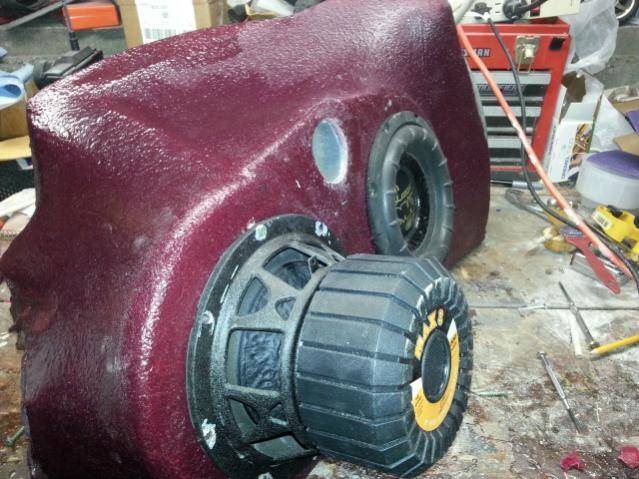

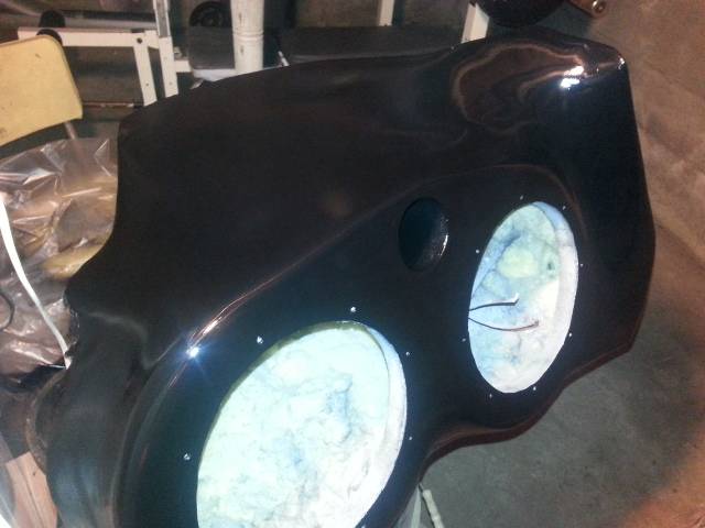

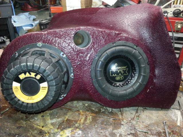

Had a bit of a set back. I sanded it with 600 grit, so I could coat it again and really get that glass look. The second coat caused a reaction that caused the paint to wrinkle severely.:confused: So i just got done sanding the whole thing down again. I will repaint it tomorrow and hope it doesn't happen again. After I do some Google research about why this may have happened. :p

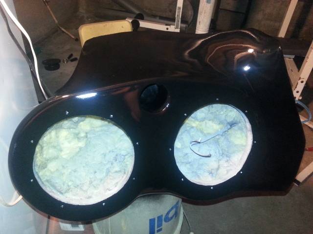

I think I'm going to make the port bigger and experiment with different lengths. Then I should be done.
Is it just sitting in there, or is it attached to anything?
It fits nice and snug in that corner. You have to put the front in first, then you have to shove the back into place with a good amount of force. Once it's in place, it won't go anywhere.

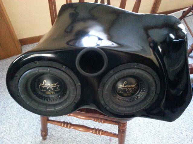

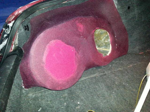

Ok, just more port. Project is officially done.
