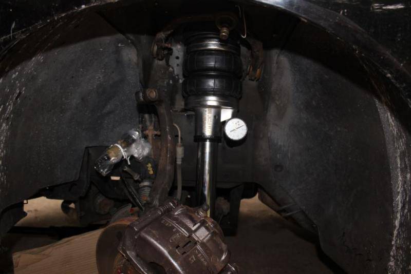

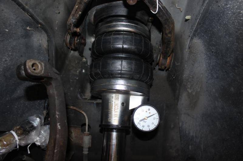

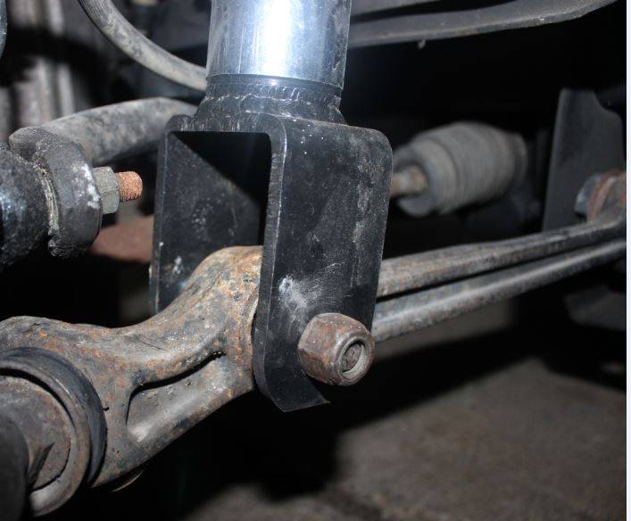

I used my Asham module to air the car up, then shut the switch off. Then I jacked the car up on jackstands and put the new one on the left front. I first tried mounting it with the gage and Schrader valve that he left on one, from his off car testing, but it didn't fit on the car that way.:)
I just used the Schrader valve for now. I aired it up and down to check it out and compare the height with the right one and bounce the car at the fenders.
I didn't want to drive on it yet, as it leaks, Eddie said that was an early problem with these. The next step is to take the wheel back off, support the lower control arm and do some leak testing.
The first 2 photos are when I first tried installing it with the gage. It would have worked for testing, but I couldn't get to the Schrader valve in this configuration, I might still use it at some point though. I took the gage off and just used the valve for now.

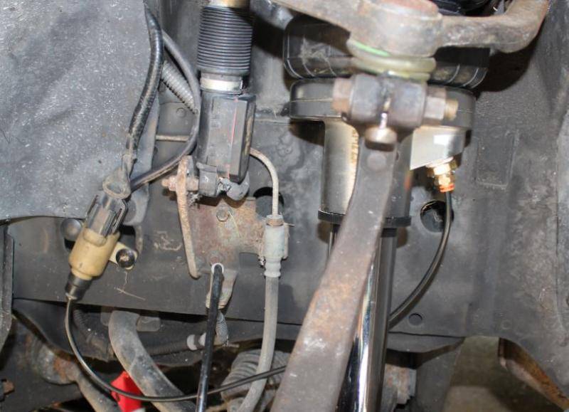

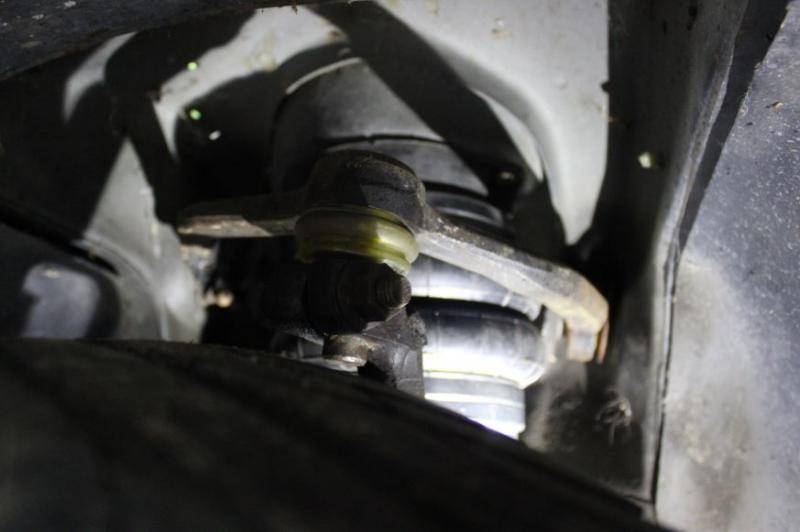

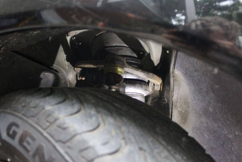

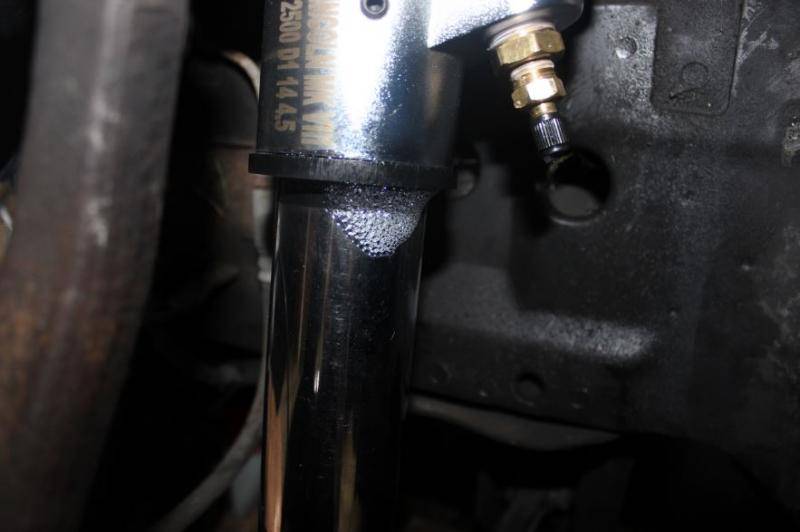

The last 2 photos show it aired up. It was tough getting photos after I put the tire back on and aired it up, it was getting dark too. I'll get some more photos as I go.:)

I got the fittings sealed up and found a small leak at the seal on the airspring. At first look, it looks like the chrome part moves up and down through the seal but that part doesn't move. I tested it, it didn't leak down after 4 hours, so then I took it out for a short test drive.
It drove fine, I couldn't tell the difference between the new one and the original one on the passenger's side. I'll test it some more of course.

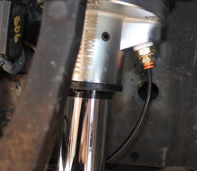

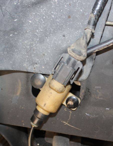

Eddie included 2 solenoid valves that are different from the Mark VIII solenoids. Instead of having one airline push in fitting and the other end with the O rings and coupler that goes into the airspring, these solenoids are an inline design with 2 air line push in fittings. I replaced the Schrader valve in the airspring with an air line push in fitting, connected the airlines, and plugged in the solenoid electrical connector (luckily it's the same connector as the original Mark VIII solenoid).
I tested it out pumping it up and venting it with my Asham module, it works great. It looks like the new one pumps faster than the originals, but it stops at the correct height per the Asham setting.
I left it sit overnight with the switch off, it dropped down less than about 3/4 inch. I think I can live with this, as some of this might even be from the the cooled down air from sitting overnight.

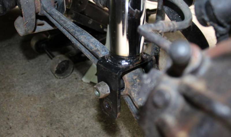

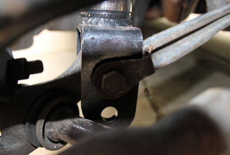

The lower bolt hole of the assembly at the lower control arm needs to be located higher, to let the airspring inflate more per height. I'll be drilling some new holes.:shifty:

I drilled new mounting holes above the original holes to allow the air springs to be inflated more at regular height.
