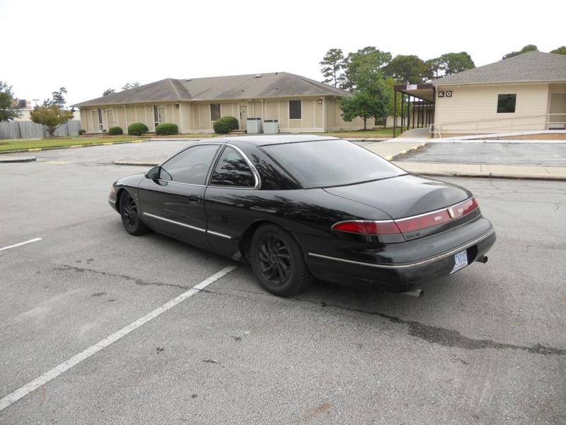

Finally got true duals on my 95 Mark Viii

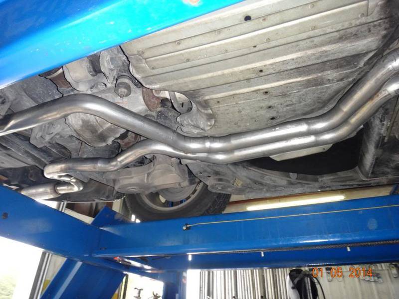

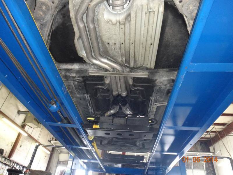

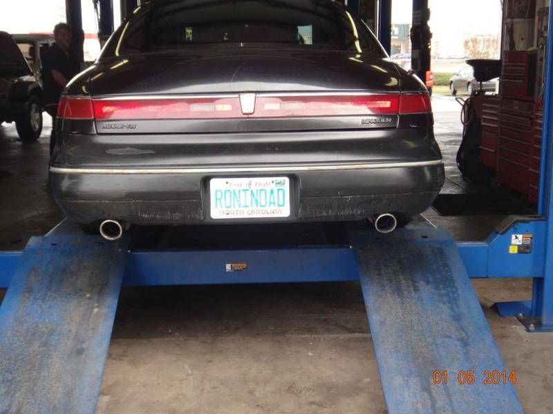

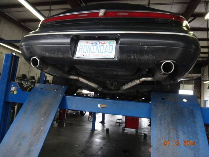

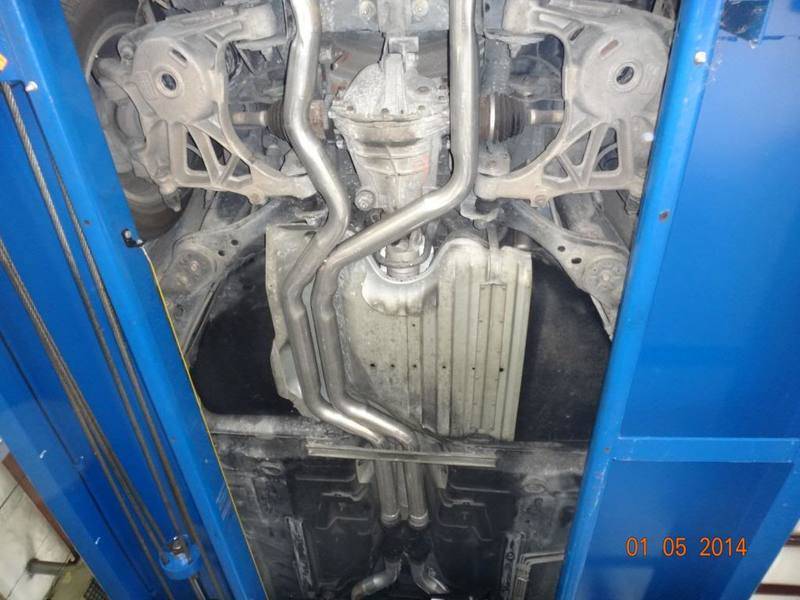

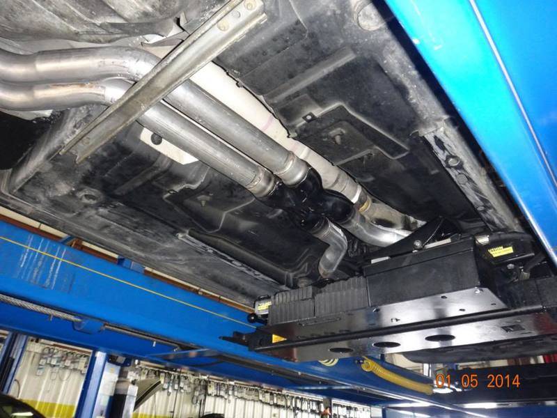

I ordered a nice x pipe from Ebay for $30 shipped and took it to my usual muffler guy to install it and run true duals. He did a great job for crush bends and he threw in some nice tips that someone threw away that were in his shop. I painted the x pipe with high gloss barbecue black paint to help protect it from corrosion. Its a little louder and more aggressive than my previous hack job that I paid a crap shop to do. Original set up was third cat in place, removed resonator with a section of pipe to the y and into two 2.5 inch Dynomax Bullets. Sounded ok but pretty boring and quiet. Pretty happy with the results and hope it gets louder as it breaks in. My videos are not loading for some reason but they are not very impressive, so I'll load some more in a couple of weeks. He charged me $300 out the door, took him 3 hours.
Here is the original set up, no tips and crap welding. I thought I took pics of the original set up but I can't find it on my camera.
Looks good..I like those tips..snyway you could find out what brand they are or what they came off of if they're stock tips. Ill be doing true duals soon and haven't decided on tips yet.
They were just some tips a previous customer at his shop had cut off and was pretty much in the trash can. The muffler guy hooked me up with them for free! Just good timing I guess.
