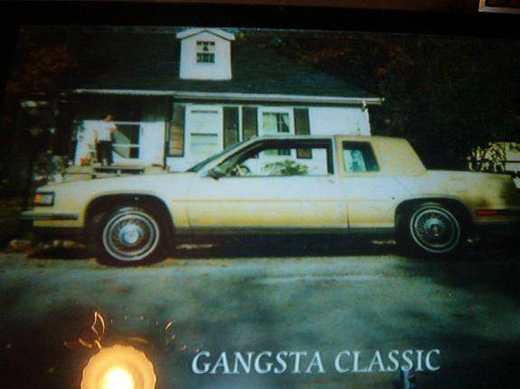

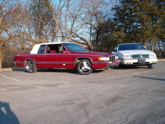

here's a couple of oddballs,one is the first small d'villes,an 85 coupe,it was fondly known as "goldie",the 2n.d is the last one ever made,a 93,dark cherry ragtop,i can guarantee you don't see many of these,there were only 168 of these produced with a full top,color and trim level,i know,it's a granny car to the fullest,but this car blew the doors off a 97 sts,which i find to be funny,considering i only paid 3,500 for it,and,at the time,the guy paid over twenty three for his seville,this car now has lincoln-like problems,rear air shocks don't purge,sits at full attention in the back,had i not already had my mark viii,i'd'v had no idea why,or how to fix it,isn't it ironic?,don't ya think?

Is the red Coupe' for sale? As far as the level ride goes it's probably the level ride control head located on the rear suspention.
It's deceiving because it has a plug in harnes but it also is directly wired to the battery and the way it's mounted you can't see that. These units do stick either open or closed. In certain instances it will drain the battery over a couple days of non use.
